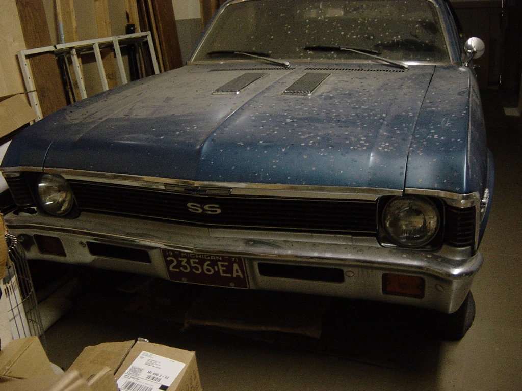

      I just shot these pics today at lunch. I only had the car on the road for a year before breaking it and it has sat since then. I never was much of a picture taker, so I don't have any pictures of when it was "presentable". I'll get some more pictures and post them. The engine bay is pretty clean, straight out of the 80's with gold Moroso valve covers and air cleaner!! LOL.
