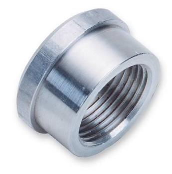

      how hard is it to install drain and fill plugs? at some point i'll get around to putting the 8.5 in my monte, and i'd like to try and keep things easy for later. (sorry if i'm not quite coherent, this damn flu is f^&kin' me up!)

      A weld bung like this is and would be the easiest way to do it, in my opinion:
      Companies like Speedway Engineering make simple weldments that use Allen Head screws like that shown in this link, shown in the "Weld on fittings" example.
      Mark Williams (page 2), A Plus Performance (a Russell part number), Bung King (use the oil tank kit), Moser... and Currie... have products available that may facilitate your idea.
