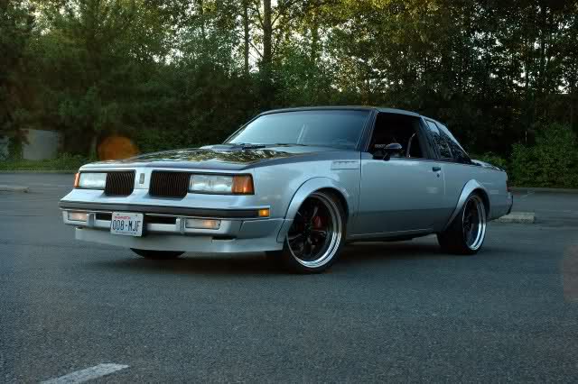

      JEFF SHORTT
      -IDEAL STEEL
      Farmington Hills, MI
      1,038
      JEFF SHORTT
      -IDEAL STEEL
      1,038
      JEFF SHORTT
      -IDEAL STEEL

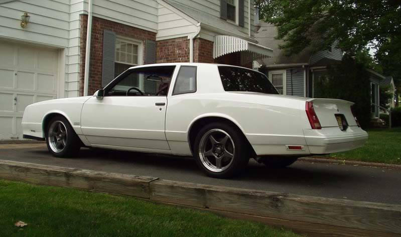

      Here's mine - '88 Monte Carlo SS. The specs and link to my buildup are in the sig if you'd like to know more about it.
      Steve Ragusa - North Jersey

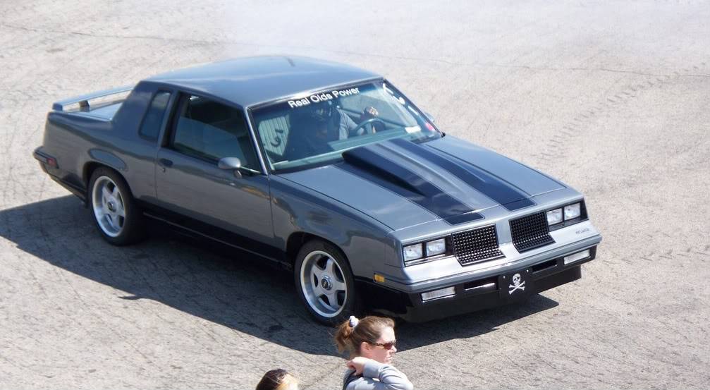

      whoa whats the story on this

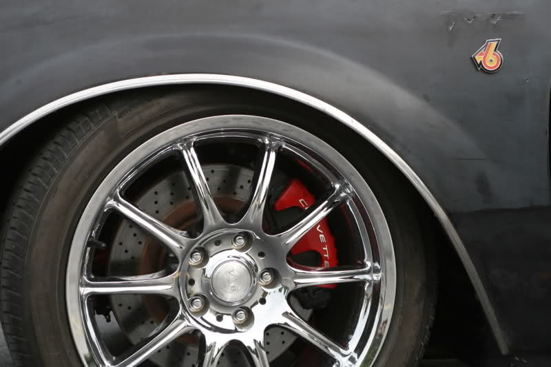

      Here's mine, in the works.

      Quote Originally Posted by Memphis
      I love this car
