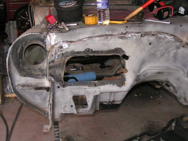

      So I ended up using 16 guage for the whole firewall. Here's how it turned out. I still have to clean up all the welds. I plan on putting the wiper motor under the driver's side fender.
