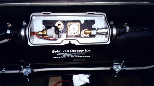

      I have a 79.25 gallon LPG system in my GMC van. and a aditional stock gas tank.
      you loose about 20% of your performance with LPG, there are systems that work with injection that can be tuned up to a 1000 hp but thats a nono for most of us.due to the costs

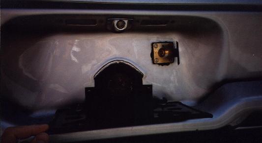

      see www.pro-touring.nl page 16 for info on my first bi-fuel setup.
      pages 34, 35 and 43 for the current LPG only setup.
