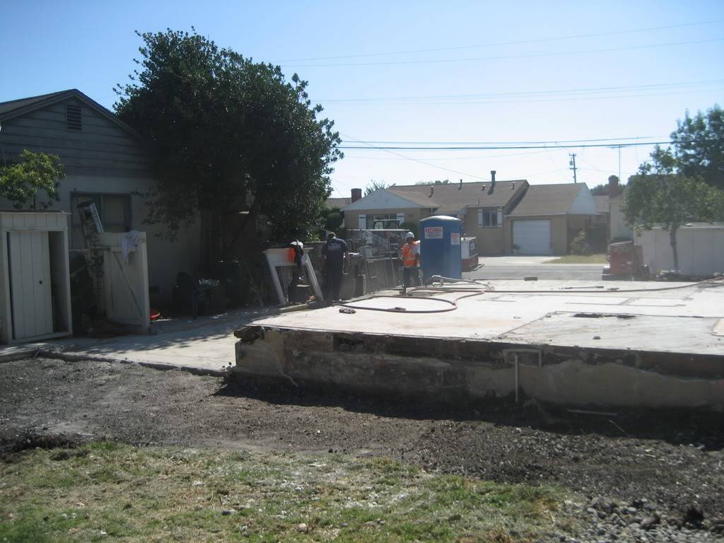

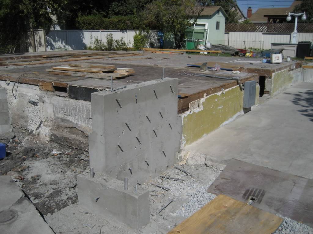

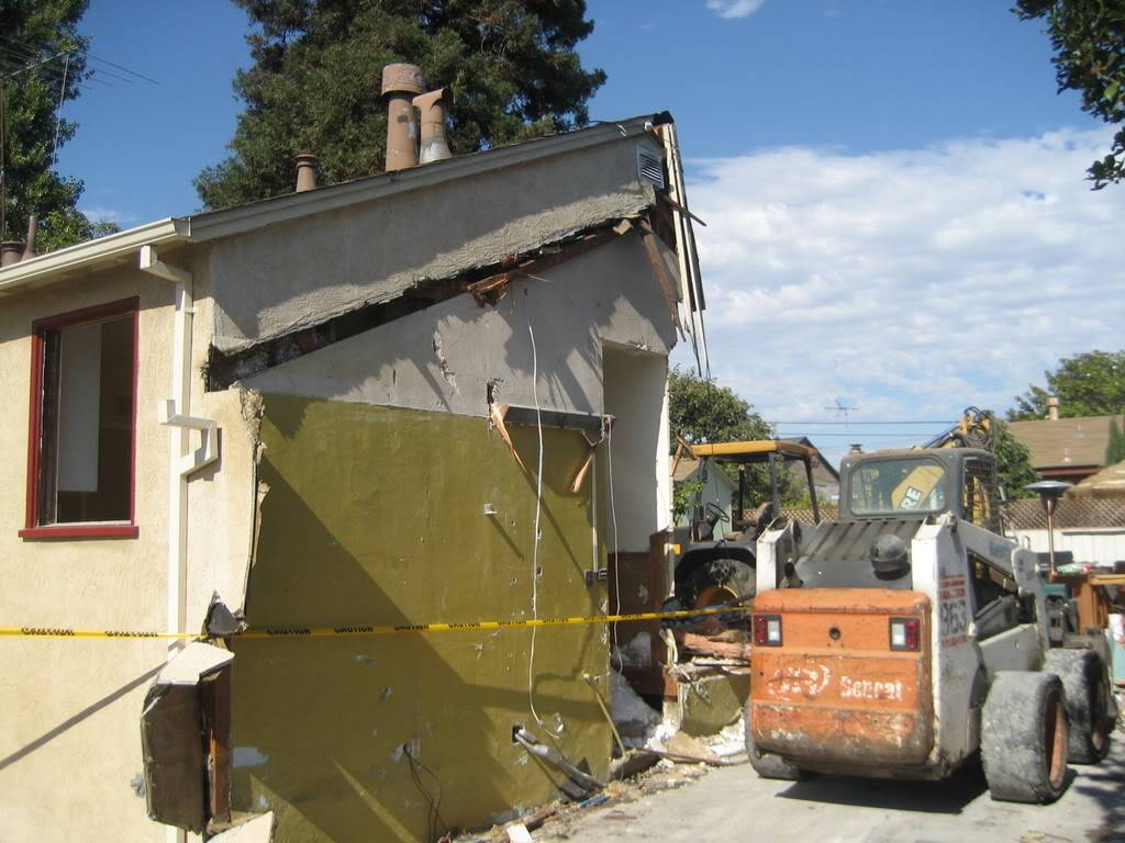

      Well I haven't been around much lately. I've been busy moving out of my house, relocating my company office.

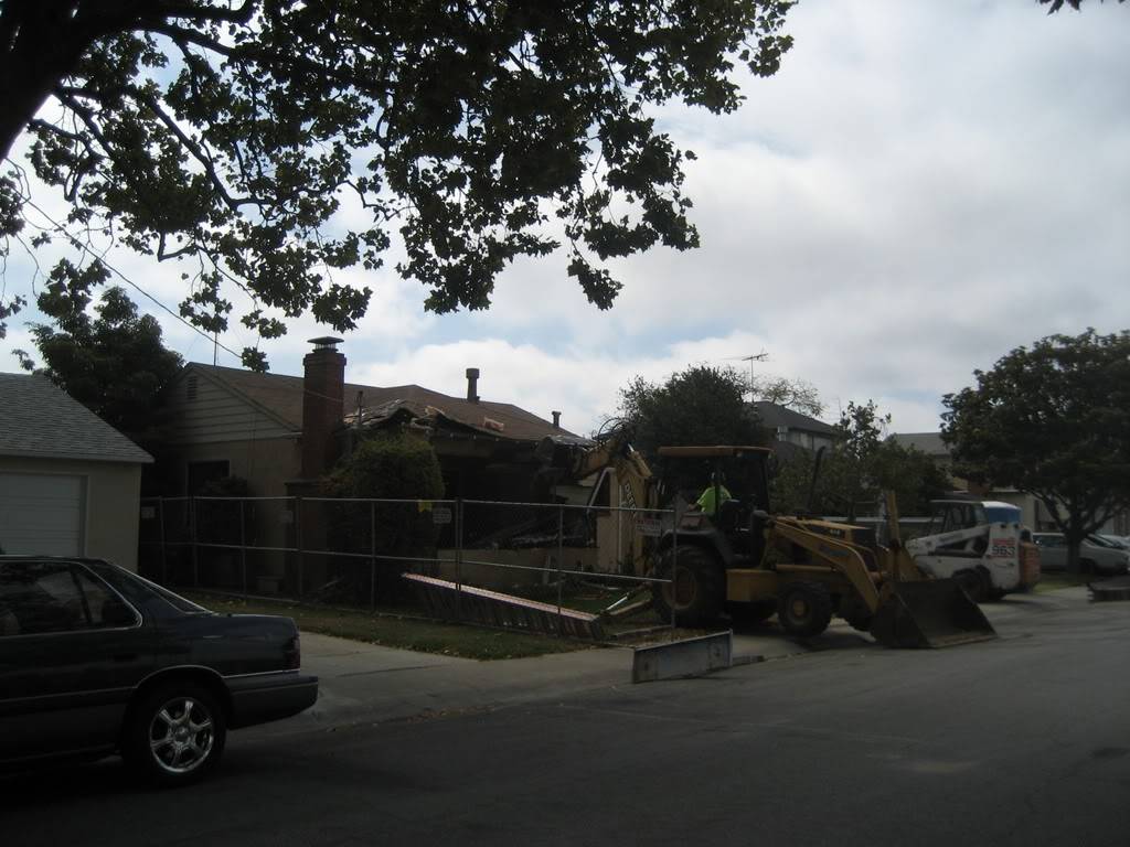

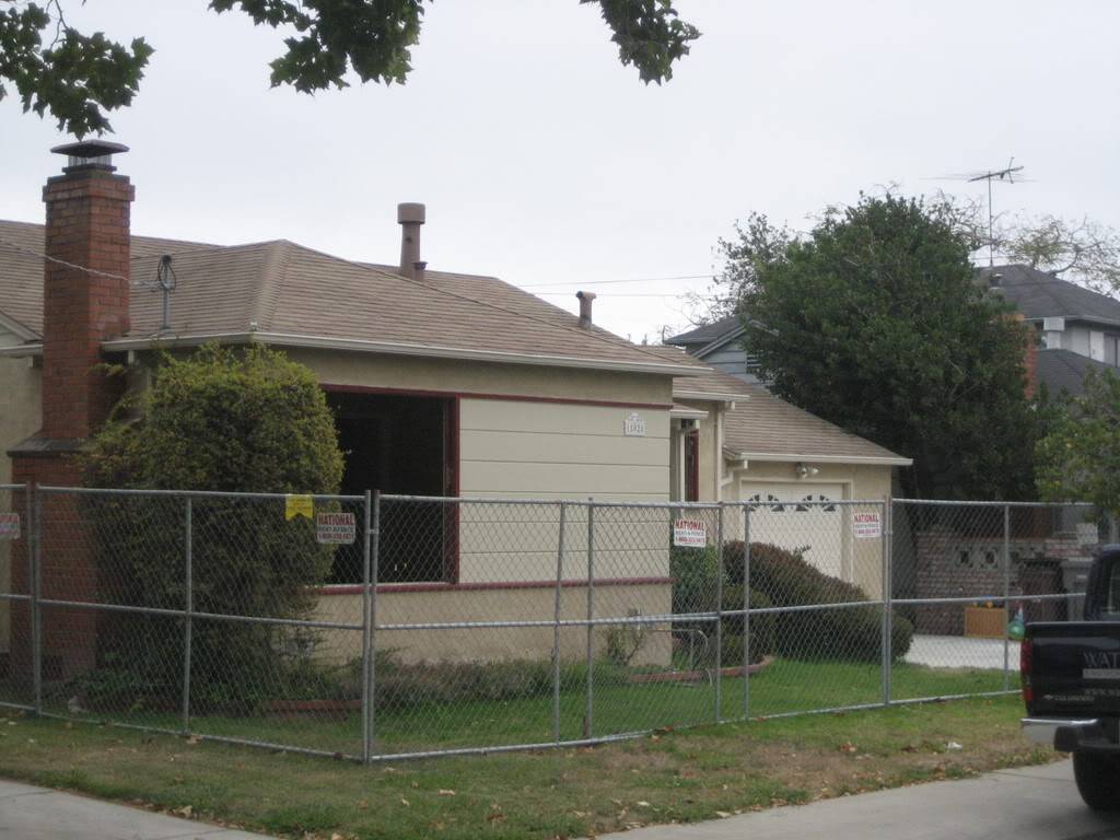

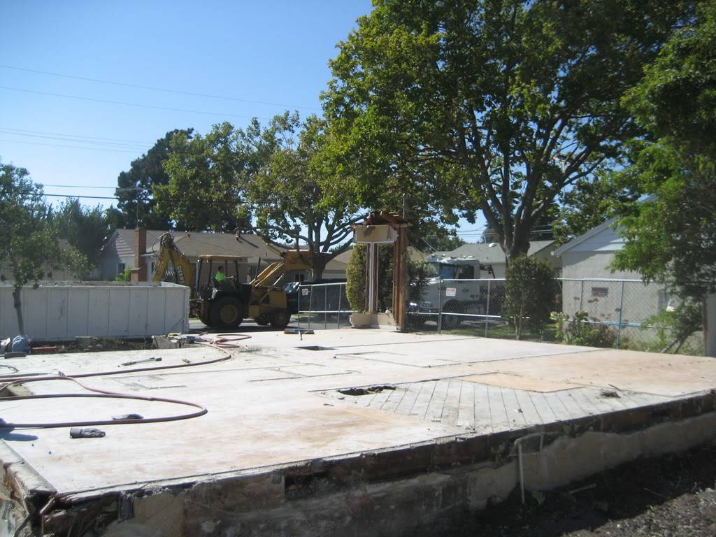

      I thought I'd post up a few pictures of what's going to consume most of my next 8 months... I'm not doing the demo or reconstruct, but am doing the electrical and radiant heat install.
      So here goes, it's a tear down and rebuild... wish me luck.
      before....
      during....
      and after demo...
      Steve

      Wow. Are you going to reuse the existing foundation?

      Yes, we are going to keep the existing foundation, but add to it...

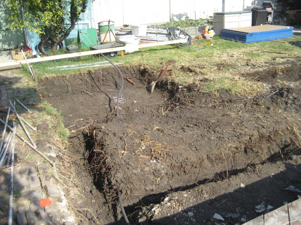

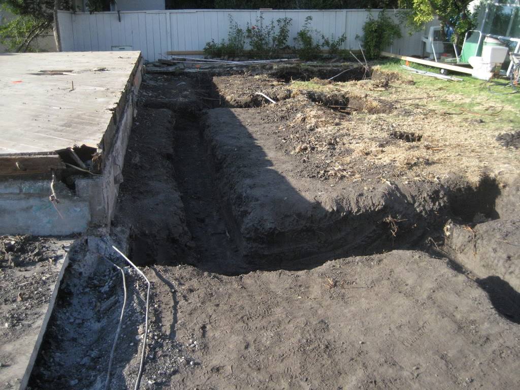

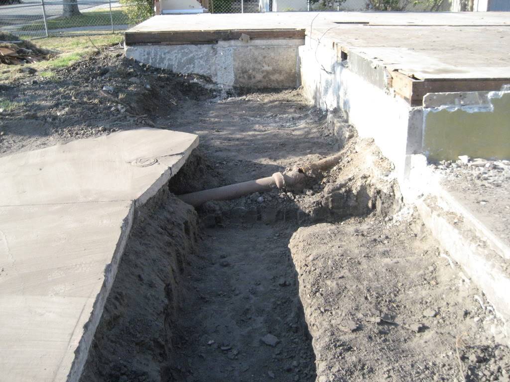

      excavation is nearly complete. Forms and rebar start Monday.
      They nicked the sewer main a bit with the excavator...
      Trenches
      Location of Hot Tub... they hit the power line to my shed....

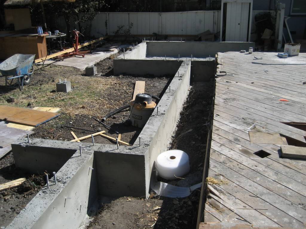

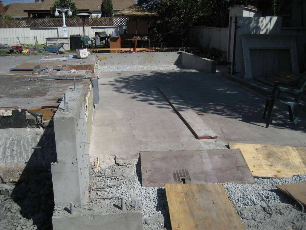

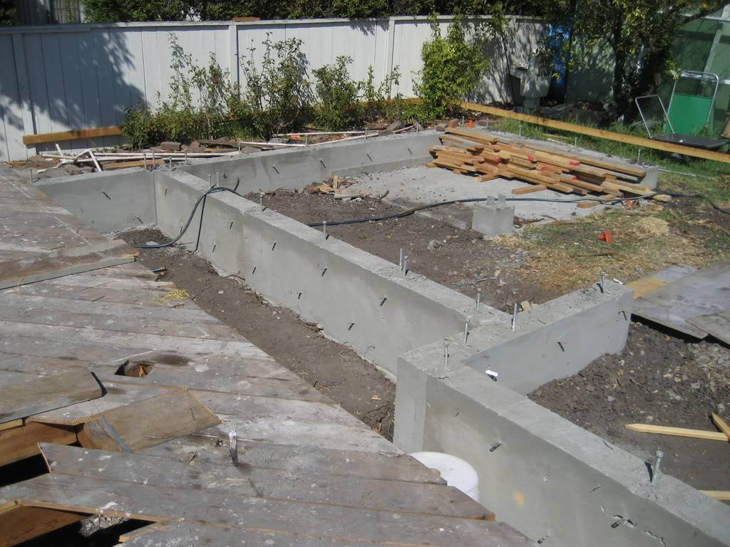

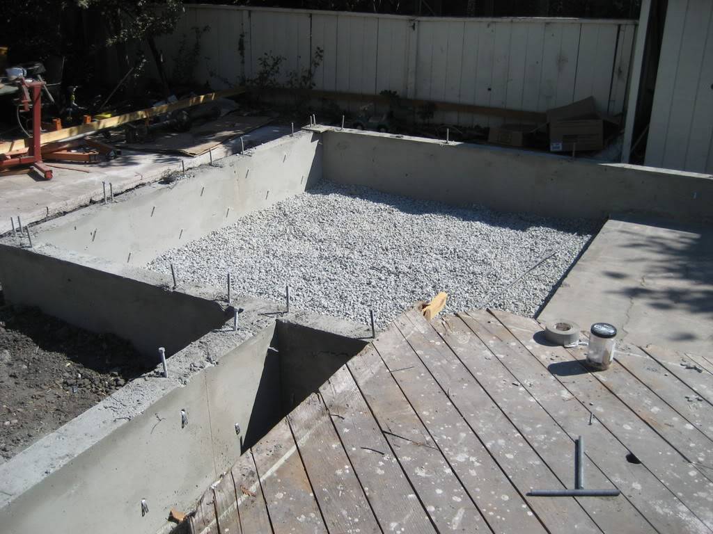

      Well we have a foundation. They poured 23 yards on Wednesday. Stripped forms on Friday. We go vertical on Monday...
