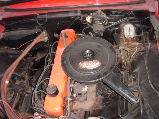

      I'm with ya on doing something different! The trouble I'm having is just finding the basic info on these engines! Is it a 230? a 250? What oil does it take? How much? What kind of filter? Just the bare basics. I bought Santucci's book, and it good, but doesn't have the basic info I was looking for.

      Here ya go John! This is how she sits now, I'd love to keep her this way, just upgrade the steering, suspension and brakes.
