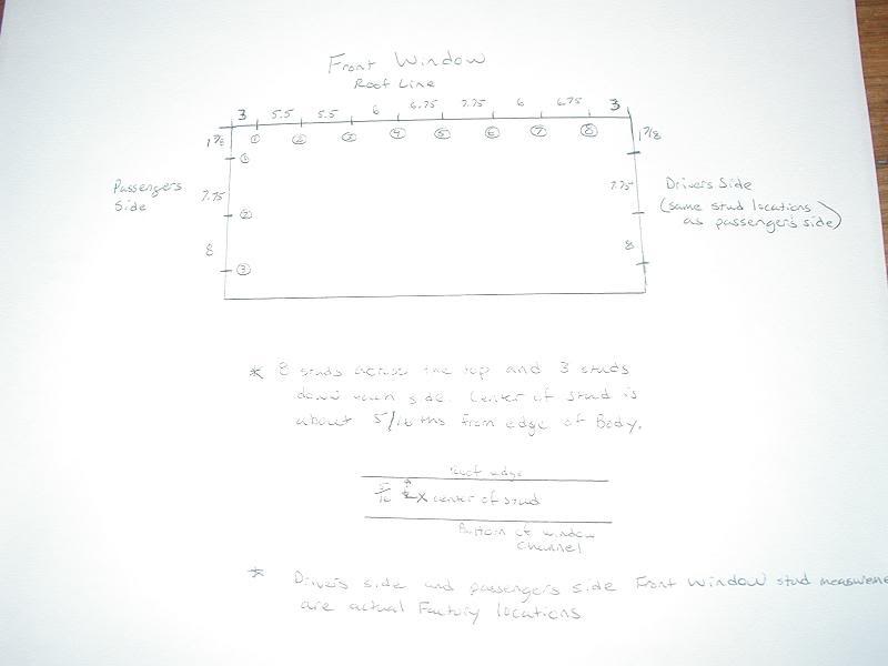

      Hi,
      Does anyone happen to know where the studs should be installed for the front and rear window trim? I replace the trunk to rear window divider, roof, etc. on my car and have no idea where to install the clips. Any pictures or measurements would help a lot!
      Thanks,
      Chris

      I found someone who took some measurements for me - Does this mesh with your car? If so, I think that we are safe to post these images whenever the question arises.
