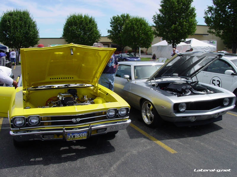

      Or just put louvers in the hood like Stielow did with El Mule.
      "Wheel to Wheel built that from an NOS GM cowl hood. They removed the inner structure and did the louvers over the turbos going into the engine compartment instead of sticking out. They also had to add bracing and move the hood latches to the corners. It's an awesome piece."
