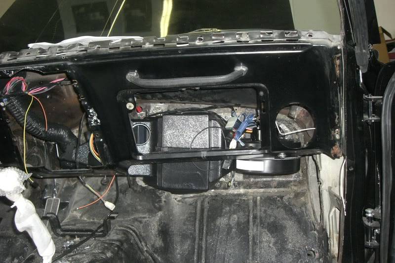

      Here's the vintage air in my 68.
      I didn't lose the glove box, but don't know how much room you'd have for the stuff you want to mount.

      Dan, thanks a ton. That picture really helps. I have already mounted the boxes, but it looks like it should be fine going off that picture.
