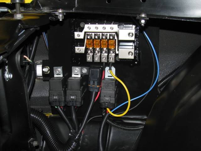

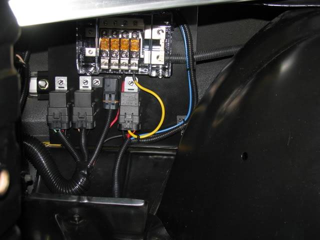

      I built this electrical center out of a piece of sheet metal I bought at Home Depot and a power/ground distribution block I found by accident while searching here http://www.sherco-auto.com/catalog.pdf page 17... the PGR4-MANL. It is a neat and compact soultion for distributing power and a central area to connect your grounds to. I have my Spal electic fan relay, and the 2 Painless headlight relays, and my audio sytem amp, all connected here. it is in close proximity for easy hook up to the battery (right next to it, inside passenger side fender). I just knew there had to be a better and more economical way to do this.

      Excellent. I'll keep this around too. I used an AAW distribution for both ground and power, but this looks very well made.

      THAT's the catalog I've been looking for! Thanks for the post!
