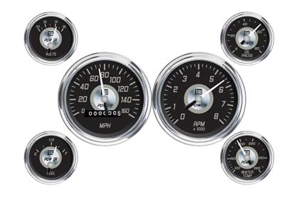

      Ok well i scorred a Covans dash and AAW wiring kit for my 67 Firebird. And since funds are allowing it I'm going to pick up some new Stewart Warner Guages These one to be exact..
      http://store.summitracing.com/partde...part=SWW-82249
      I was originally going to just install my stockers in there till I could afford to get these. However, i made some really good tips this past week and have enough for my guages and possibly a whole new wiring harness for the car. First question is if i get the new wiring harness for the car does the harness i got with The Covans Dash already come with the new kit? If so How do i order it without it. Second How long would you expect it to take to rewire the whole car?

      Problem number two... I have the AAW Kit to wire up everything but i do not have blade terminals on the back of my SW Gauges to plug into the AAW harness. Does anyone know where i can get the blade terminals from?
