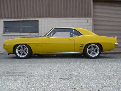

      Yeah Alex,that's mine...let me see what I have on file w/V-40's for you:
      That's about all I have on file with those wheels from those angles you asked for...I can tell you they are VERY high quality wheels and they are a great period-look for any '60-'70's musclecar.

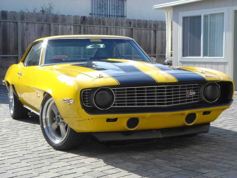

      That was exactly what I was looking for. Thank you so much. Your car is the one that made me go "DAMN, THOSE ARE SOME HOT WHEELS..." lol. That is a killer looking car....
      I know you have 9.5 inch wide wheels, but what are the different backspacing and tire sizes ?
      I think I'll set the backspacing up similar on my car and run the same size tires.
      Is that CF spoiler readily available, how much does it cost ?
      My friend has a repro glass Camaro spoiler on the front of his 68 Charger and I'm going to do the same on my car.

      Yes,I have assorted 9.5" rears I run on both Camaro's and the b/s remains a consistant 5.5".I run 285/40-17's w/o issues,but some cars will require a 275/40.

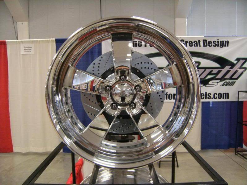

      Another option would be the Rushforth Wheel "Fuel". Order it with a Charcoal Grey center, and you would have the right look for that car, in a billet wheel.

      By the way Jon,Fuel is looking better everytime I see it...have you done a grey-centered display wheel yet?

      John, Fuel is one of my favorites, although I love them all....
      I was hoping you were going to order a set in that finish for the Camaro, but then you go and surprise the S out of me with your Super Spoke order in Titanium finish.
