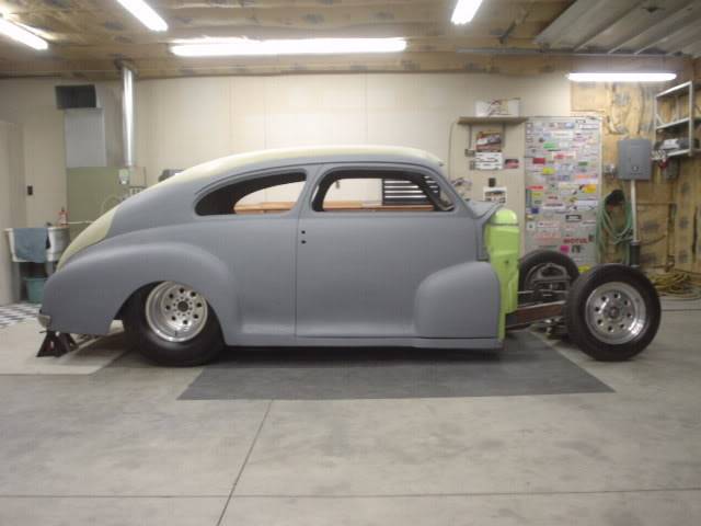

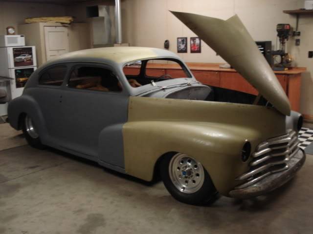

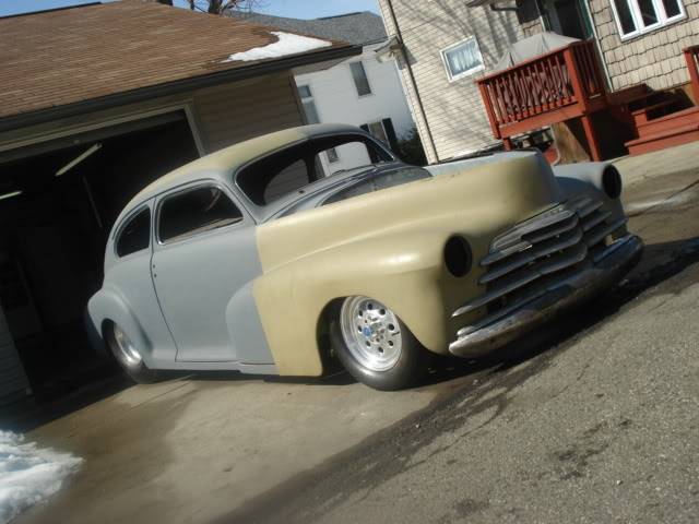

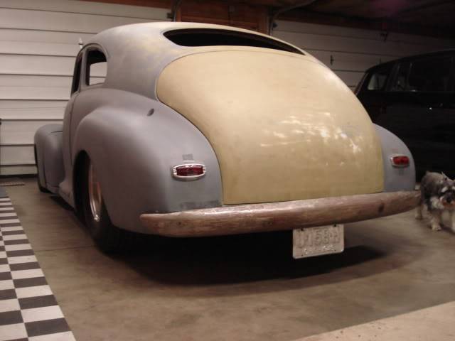

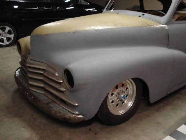

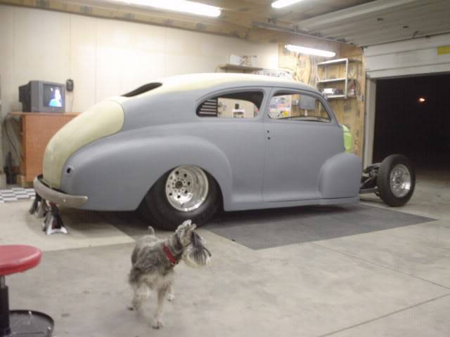

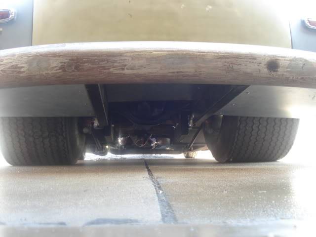

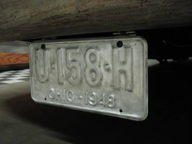

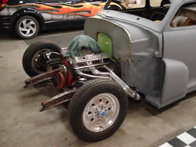

      Thanks guys its still in mock up yet getting ready to come back off the frame.

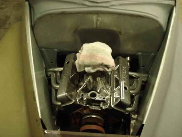

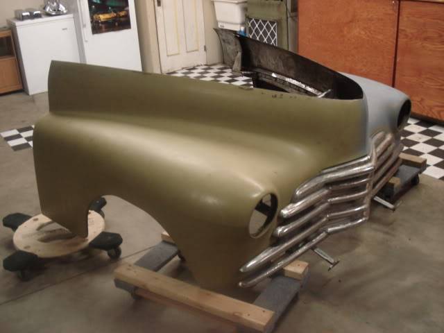

      It has a ton of subtle mods welded the fenders to the body flipped the bumpers moved them closer to the body custom built rear belly pan smoothed all the trim and emblems nosed and decked!

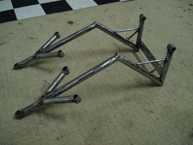

      One peice tilt front end and a panckae stlye hood opened backwards. backhalfed with a narrowed 9" 4.30 gears and a locker 4-link on air ride.

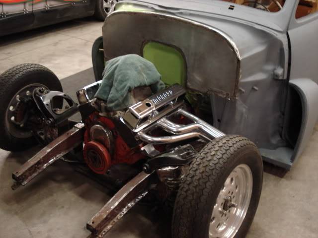

      Engine is a 1970 4bolt 406 10.5.1 Mahle forged pistons and Scat crank and 6" rods PP polished hurricane intake 750 mighty demon and a IK Brodix 200cc Heads Fenderwell headers. 350 turbo 3,500 stahl. Getting closer on it but all custom metal work that has to be right is taking awhile but no hurry. Glad you like heres a few other photos. Later George

      That engine looks so small in there! I'm not a fan of the one piece front end, but it still looks good.

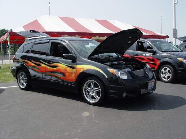

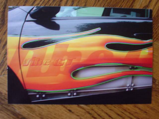

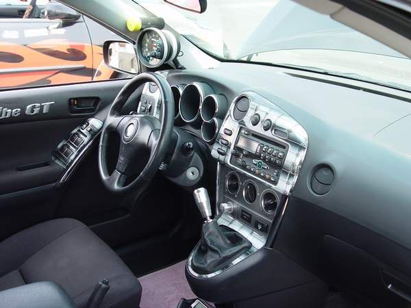

      Paint on that Vibe looks killer
      Thanks its all metal not glass and is a tilt unit i built. way easier too work on car ecs. engine!
      Thanks the Vibe is all vinyl half wrap Glad you like. lol its the work car!

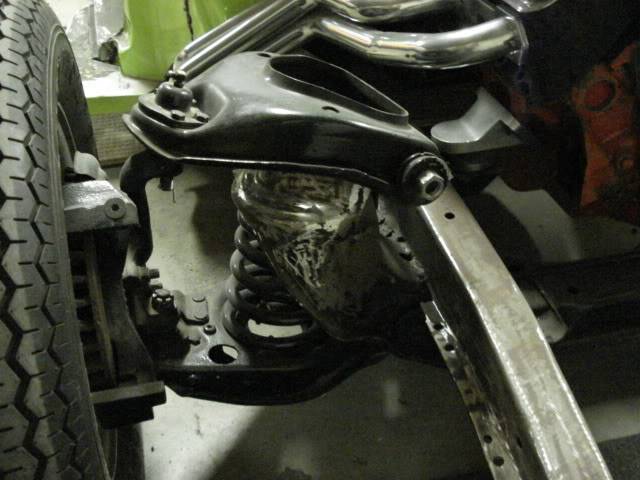

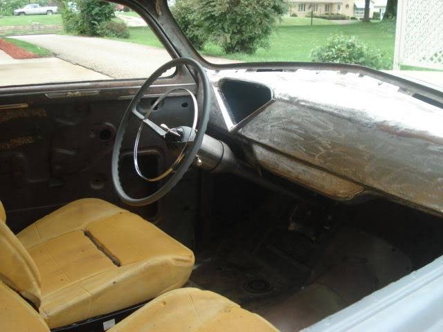

      Pacer IFS, right? How was that install?
      PS; That dash is SWEET - I've always loved the 55-57 Chev PU dash...

      I can see why the one piece would be beneficial, especially when its fiberglass. The fact yours is all metal is cool, but still just not my style. Nothing against your car, or the way you are building it.
      Have any more recent pics of the Fleetline, or are those the most recent?
      That Vibe does look cool, thanks for the pics of it
      Thanks guys the Pacer front end is an old rodder trick for these late 40's cars and trucks the frame cradle welded real nice up to the orginal frame rails and went in from the bottom! Nice because they utilize the big disc brakes and sway bar and rack -n -pinion aswell Trying to finish the metal mock up been working on the house the last month but ready to get back at it have my hinges built from scratch and the hood lined up just have to build a latch on the backside of the hood near the cowl, so a little more work but ready to start working on frame.
      To get my air ride in and start smoothing it up!
      New motor mounts i just bought will have to use a different set up will have to get them welded in and start breaking car down.
      Will be running different wheels and amoung other thing most of the parts on now are for placement. heres a few recent pics!
