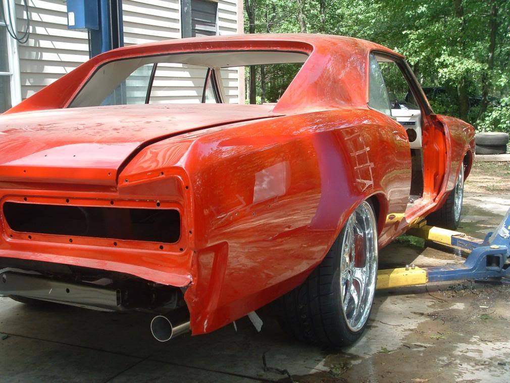

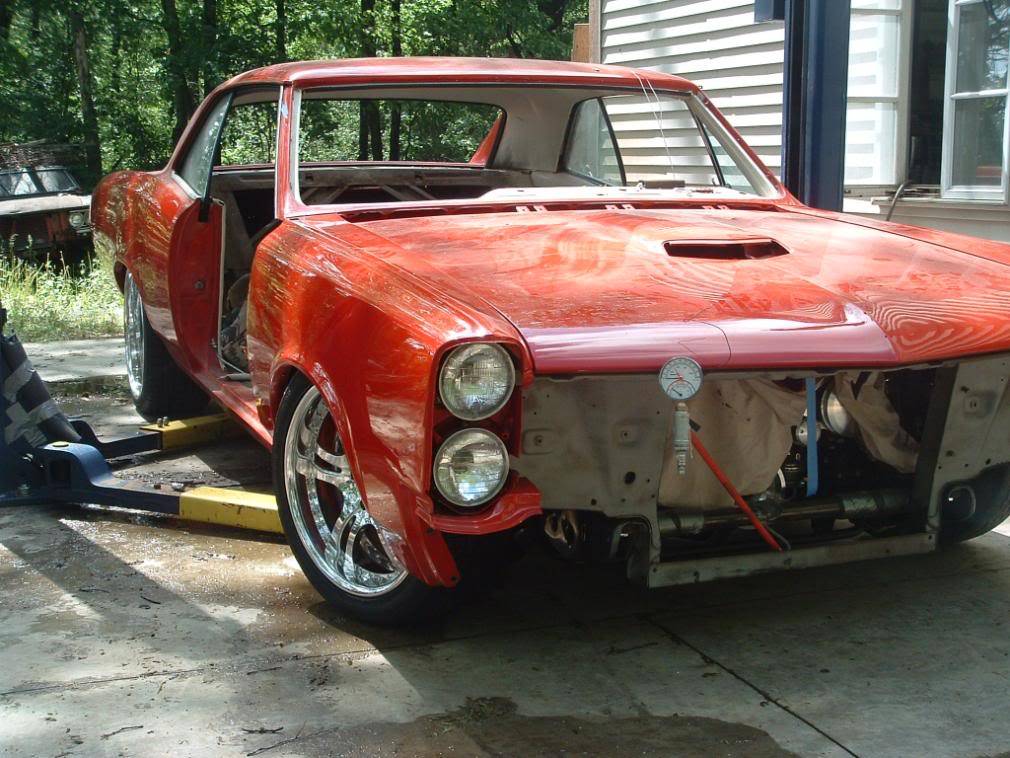

      Well, I finally mocked up my Rushforths to see how they fit. When I ordered them I knew I was going to have to roll the lip and modifiy the exhaust but it turned out better than I thought. I still have alot of work to do tho.
      They are 20x10 and 18x8 super spokes
      Let me know what you guys think.

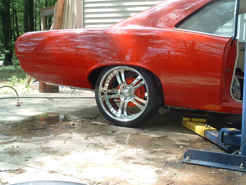

      Kal,
      The wheels & stance look really good, but please don't leave the rear drums painted orange. There's no sense drawing attention away from the high dollar wheels to a big ol' pair of ugly drum brakes.

      I agree... its just my bro wanted to paint them. I'm planning on getting some disc brakes but the money just isn't there right now.

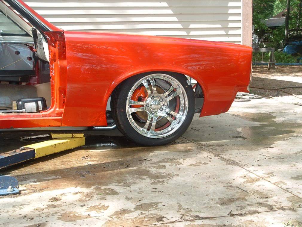

      I went with 20x10 with a 285/30 tire and 18x8 with 245/40 tire. I believe the backspacing was 5 3/4" in the back and 4 5/8" in the front... if i remember correctly.
      With the 5 3/4" backspacing I'll have to roll the lip of the wheel well but i wanted the extra space for my 3" tail pipe. Which i will have to modify a bit.

      Here is a pic from the back to give you a idea of what the width looks like. IMO the wider the better Jope this helps.
