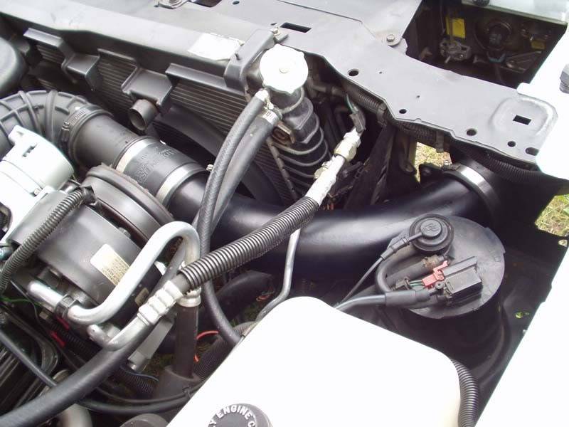

      I made this up pretty easily.
      The elbow right off the throttlebody is from an '88-'89 Trans Am into the stock TPI MAF, then I have a 3" coupler from the plumbing section at Home Depot, and the large 3" elbow is made from gray electrical PVC, then sprayed semi-gloss black to match the engine bay. I have a large 8" K&N cone right on the end behind the headlight.
      The electrical PVC works great because it has the smooth bend; plumbing PVC doesn't work as well.
