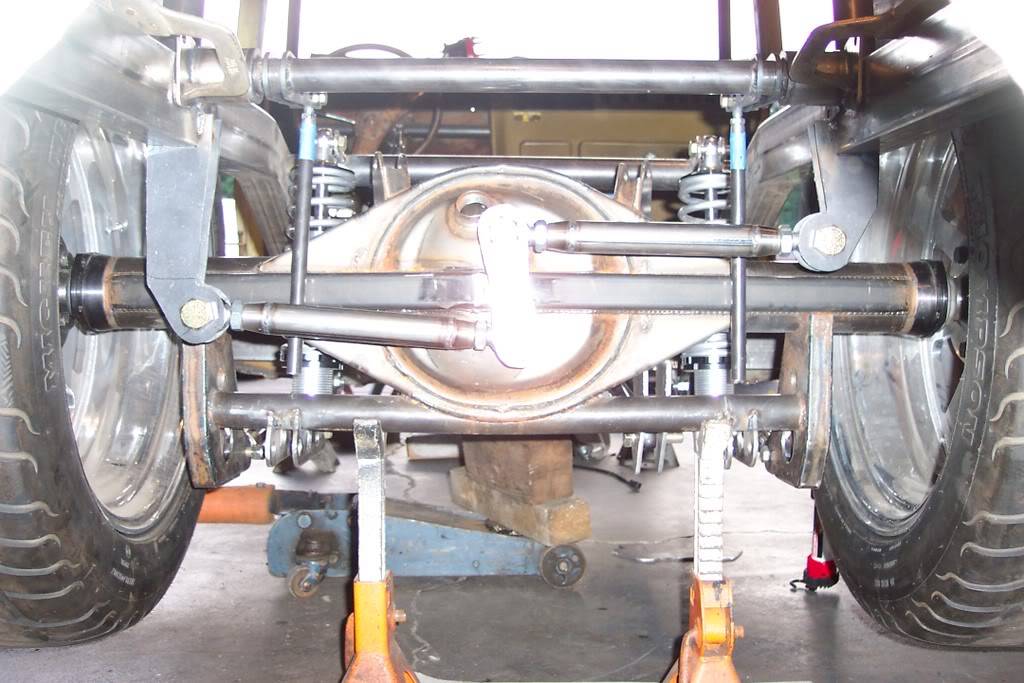

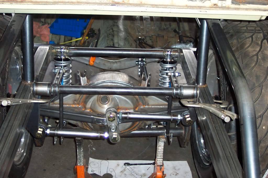

      Swivel
      I will make my own after looking around.
      That setup looks pretty slick.
      Do you have any pics of the center swivel piece? What did you use for bearings?
      1970 Dodge Charger - Viper V10/6spd
      May 2002
      Northern California
      10,716
      You can use a standard flat press fit roller bearing and have the cage hole drilled to fit.
