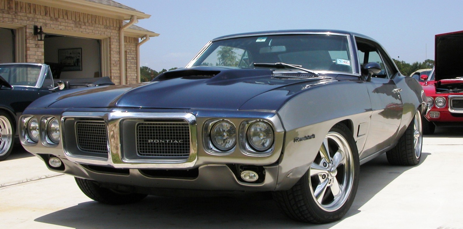

      I finally got the front wheels from Boze after 10 weeks. They look awesome! In process of installing the new narrower rear end and will be ordering the rears in a couple days.
      Fronts are 17x8 with a 4.865 BS with a 245/45/17 tire. Rears will be 18x10 with a 295/35/18 tire.

      wow those are nice!
      id paint your calipers the same color blue and call it done.

      lookin good. i love the finish.

      The rims look great, acutally your whole car looks great. Definately will have to post up a nice view once the rear gets situated.

      Thanks for the comments. Hmmmm, hadn't thought of painting the calipers Blue.....
      Here's another pic with the wheels I am replacing with the Boze.

      Got the new rear end in place and measured for wheel fitment. I put a 78 Trans Am rear under my 69 Firebird with LT1 rear disc brakes. It was exactly 1/4 inch wider than the factory BOP 8.2. With a 295/35/18 tire mounted in an 18x10 wheel it is perfectly centered in the wheel well with 3/4 inch of clearance on both sides of the tire the backspacing will be 6.125. Fronts are 17x8 with a 4.865 backspacing. Absolutely no rubbing.
      Ordering the rears TOMORROW!!
