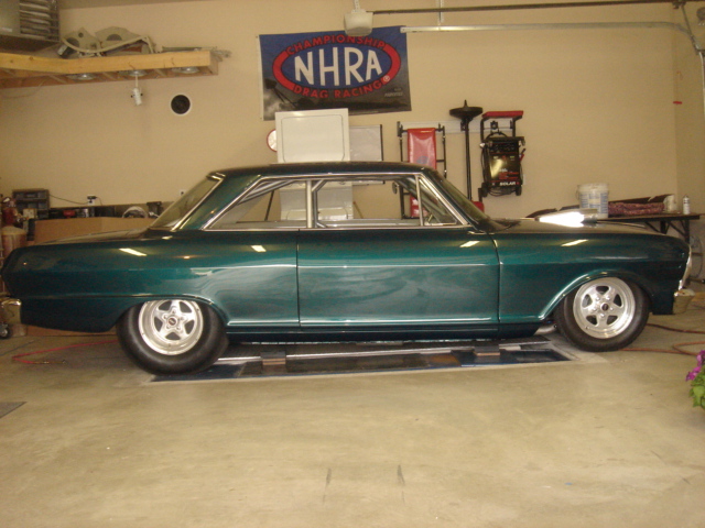

      It is time to order some new wheels. One question I have is ,drum verses disc, Will this make a diference in ordering a wheel. I want to put some 20" wheels on the dana 60 with a 295/40/20. What set up should I look at so I do not have to do this twice,wheel / disc/ tire?
      This will be going on my 65'.Name:  DSC02423.JPG

      I may be wrong, but drums or disks, it should be the same for wheel fitment. 20" wheels give you lots of room for brakes!
      The rotor should be about the same thickness as the drums, where they mount to the axle flange.

      I think it will depend on what drums you have now and what disc brakes you are getting.
      Do the brakes first then measure for wheels maybe?? A 295/40/20 is like 29.5" tall......pretty tall tire. After all you dont wanna be rollin 20's with drum brakes lookin thru

      Discs tend to be about 1/16 to 1/8" wider than most drum setups, the difference between the thickness of the hat of the drum and the hat of the rotor being used.
      You can go big inside 20's so long as you can fit the calipers behind the spokes, which is never a given. Even a relatively small caliper like the rear C5/C6 can have major fitment issues depending on the wheel design and offset. The sweet phat lip design on many of today's wheels tends to push the spokes into the face of the calipers, regardless of wheel diameter. It's my opinion that you're typically safer to determine what your braking needs are and how you plan to fill them before you drop a bunch of coin on wheels.

      Thanks for your input everyone. I am planning on going with Super Spokes (--as soon a the group buy starts again-- ) and a 13" rotor, I am running wilwoods on front. I thought about doing the disc setup first ,just trying to save time, but believe me I would rather save the coin by doing it ONCE. Just want to make sure everything is in order before I make the plunge.
