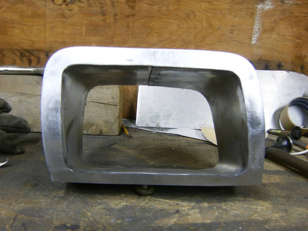

      Thanks for the help! and yes these are tips to come through the pan

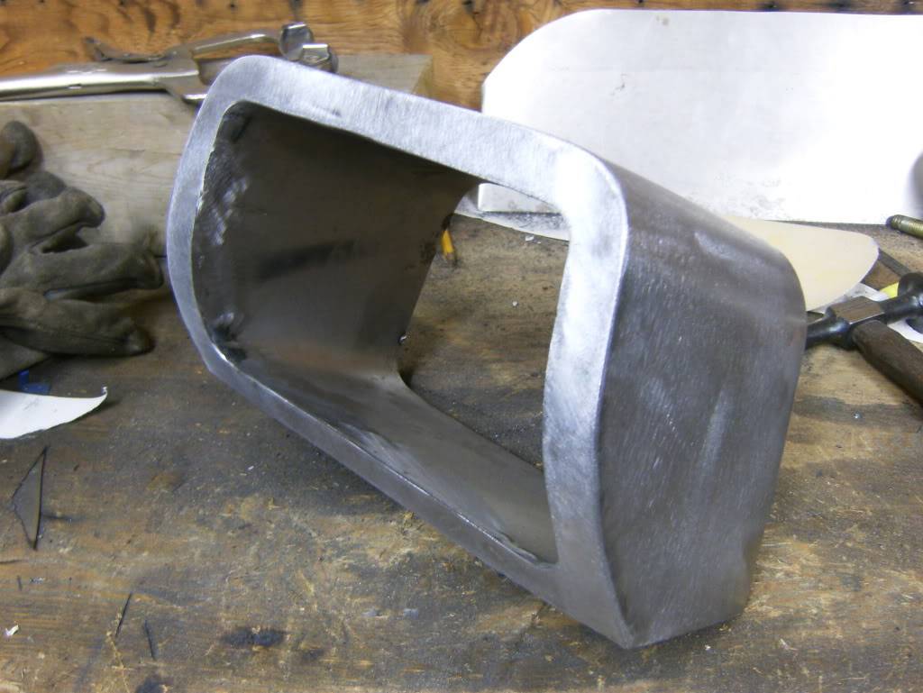

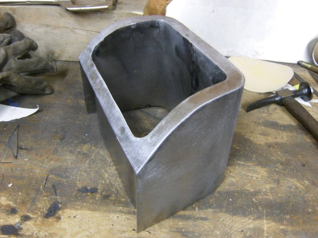

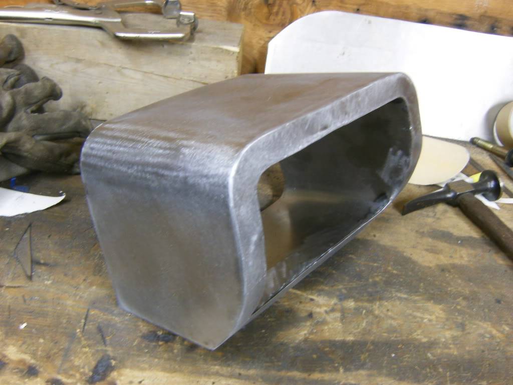

      Tip done, I'm contemplating painting silver or chrome powder coat.

      So that tip is made out of ga. metal to look like it is probably a half inch thick?....cool, looks like a lot of work went into that.
    8. #208
      May 2007
      249
      yes sir, 18ga. to be specific, too match the exact dimensions of the front SS duct

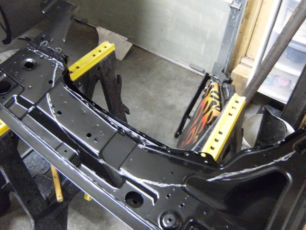

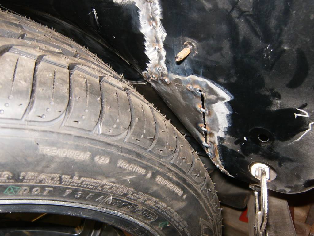

      holy crap an update!

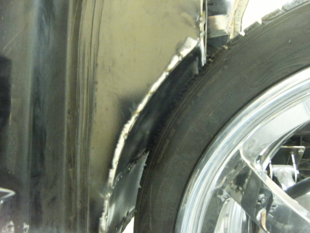

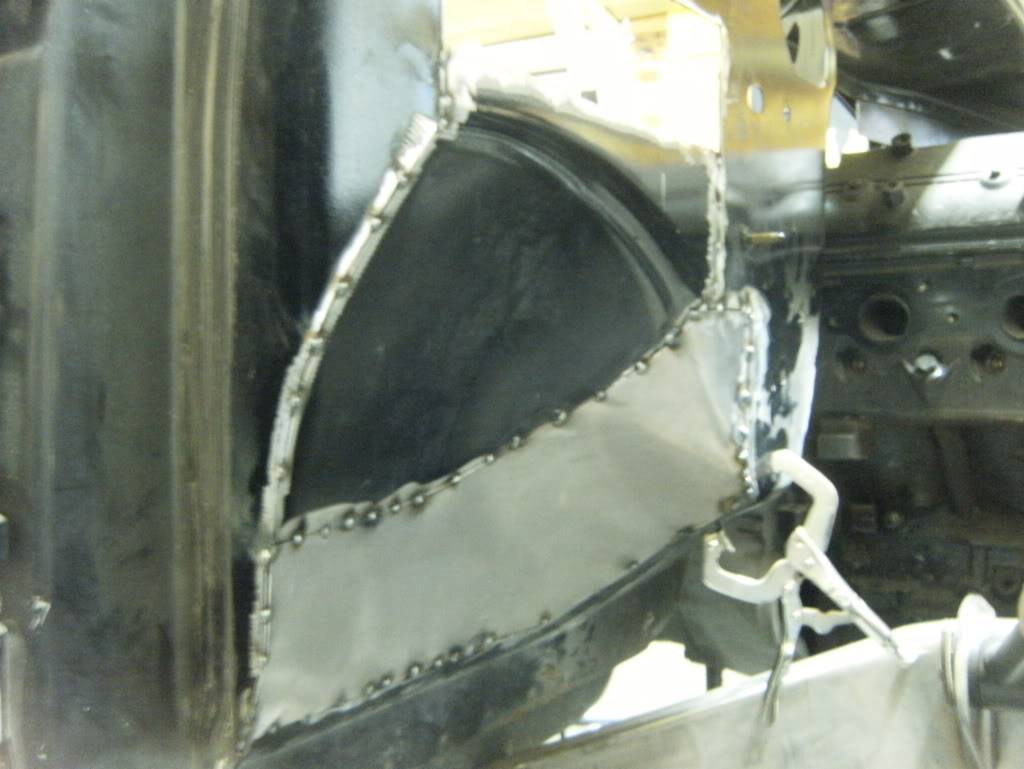

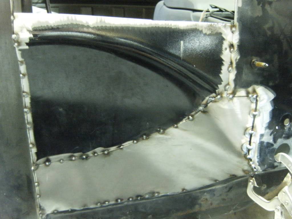

      well after a little over a month I took Sunday off to relax and work on my truck, didn't get TOO much done, but back on track.
      Tubbed the otherside of the firewall, raised the factory tub of course
      Clearance
      Full lock at 2" ride height, not that it matters since I wouldn't be able to turn that much with fenders, but just goes to show I made them wide enough to allow adequate turning

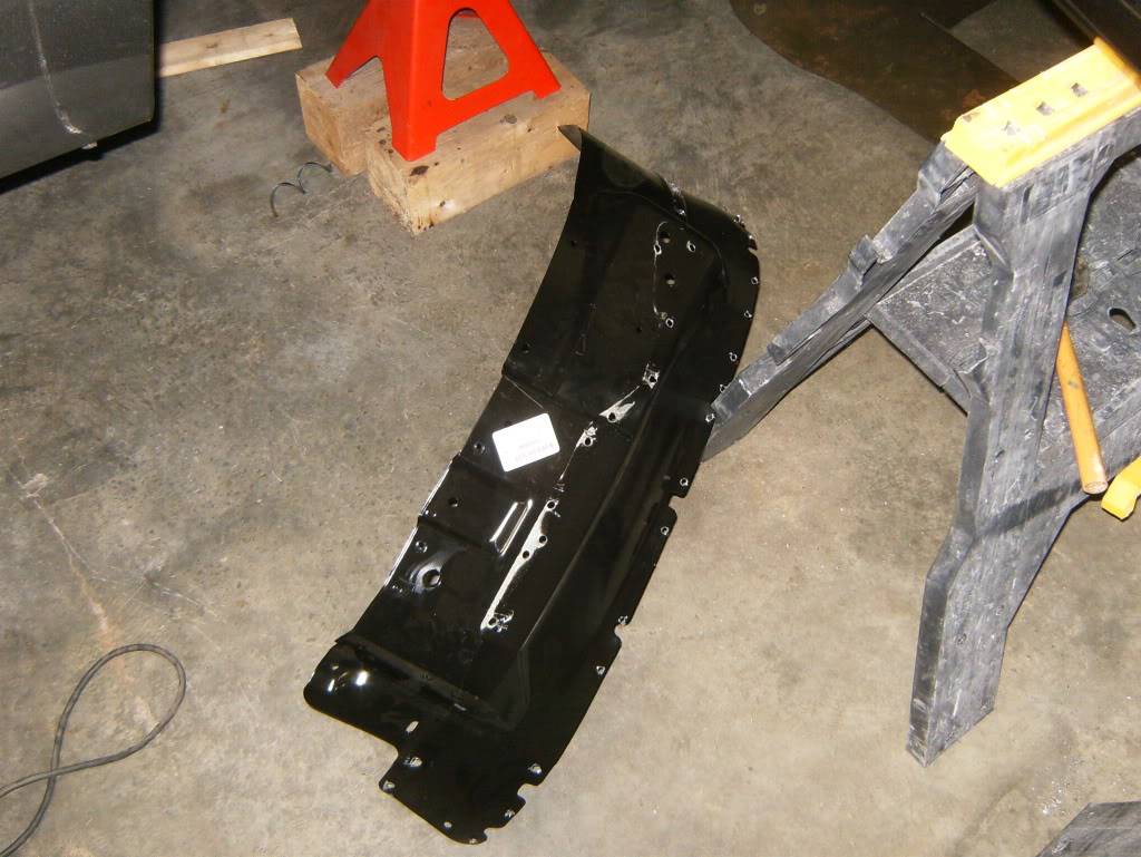

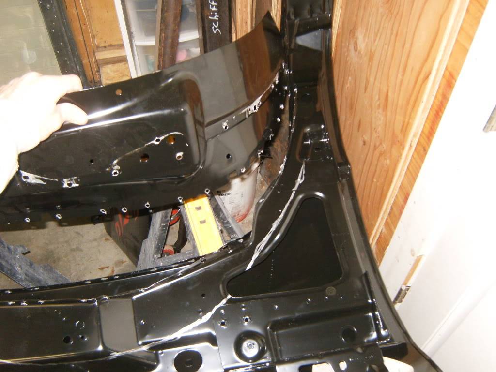

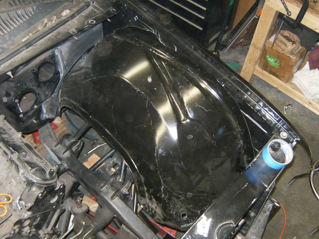

      Started on the fenders, bought two brand new OEM fenders, and proceeded to drill the spot welds out and start cutting.
      Test fit and marked for height
      Cut and now to the special part, ordered two pre-99 inner fenders, going to try to make them work. They taper to quickly so they sit pretty high here, but I'm going to try to modify them. I actually have them installed opposite also, drivers on passenger. Worked better that way.

      motivators video updates gave me the idea to try these out
      here is a above picture
      http://www.youtube.com/watch?v=0cZJXAgbISE
      http://www.youtube.com/watch?v=0EyTyml-6pk
      Let me know what you guys think, I agree to what people keep saying they look big, but I think it's mainly because the motor is so bare. Once the engine bay is filled out it should look a little better

      Looks much better with the filler panels. As for the size I do not think that you can get around that being that you need that being on airbags.
