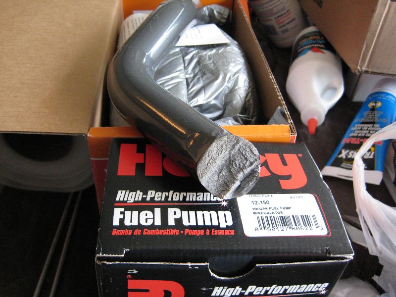

      Ordered the stuff on the 5th from Summit, and when it arrived I inspected everything. Everything was fine, except for the front bar. The front bar was in two pieces!
      I called Summit, and they shipped a new one out right away, and the new one arrived yesterday in one piece. UPS picked up the broken one.
      There was one hole in one end of the box where the end of the bar had poked through the box, but that hole was at the opposite end of the box from where the break occured, so I'm thoroughly puzzled. ST says it would take a huge amount of stress to break that bar.

      ST says that it's a freak occurrence.
      The box itself was not damaged other than the small hole just large enough for the end where the endlink goes to poke through.
      I'll try to get a picture of the new bar and point out where the break occured on the other one, but it's right in the last tight curve of the bar out near the spindle.

      it's definately strange. you almost never see sway bars break, even if it's 30yrs old. if there was a defect i could understand it, but from the pic i don't see one. either way, you've got the new one. let us know how she handles.

      Forged? They may forge the ends, but the bar itself is most probably cold rolled then bent hot or cold (I'd guess hot). The forging, if done. would be to provide some profile or shape for the swaybay link

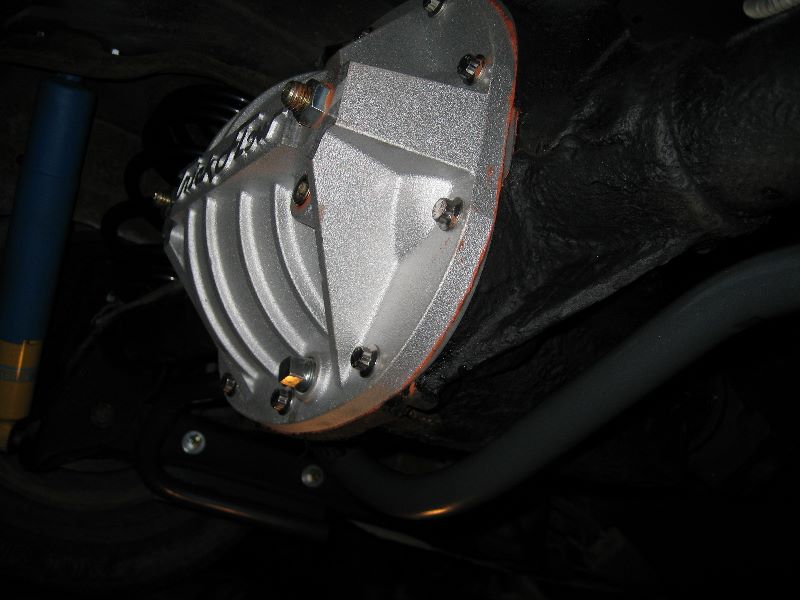

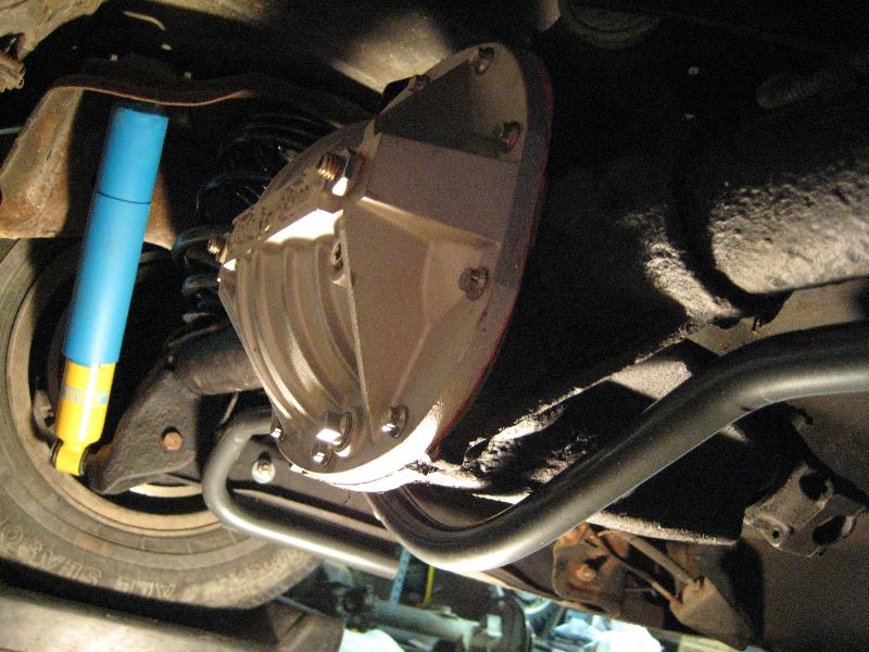

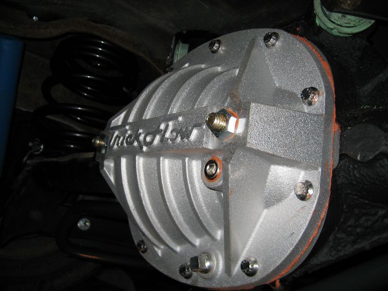

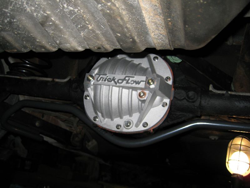

      Had a gathering at the house this last weekend, and got some work done.
      The night of the gathering at the house, after we ate dinner (I cooked Manicotti for everyone that came), we worked on the car a while. We got the pinion seal replaced, while a couple of guys started getting the front passenger suspension taken apart. But that was all we managed to get done.

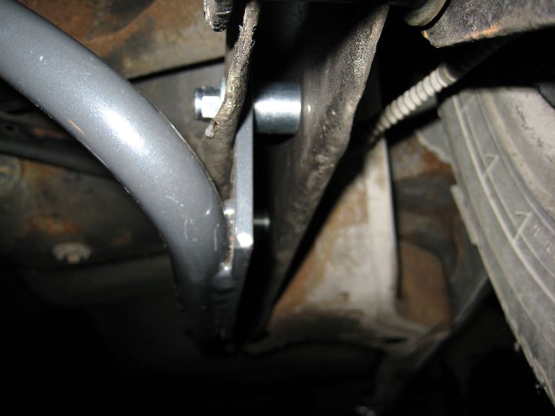

      Sunday I installed the pinion yoke, the new diff cover, and the sway bar. So the rear suspension should be complete now. I had already installed the swapped in rear (3.73 from a Monte SS), Eibach Pro-Kit springs, and Bilstein HD shocks with new bushings and fresh brakes.
      The rear sway bar installs in a really odd way, check out the pics:
      Notice that the sway bar bolts in the center of the U channel on the lower control arms, and that there are no bushings to hold it to the rear end. I've never seen a sway bar mount like that.

      Yep, I have the same rear sway bar. Nice design IMO. But I have to alter it to fit the tubular LCA's. But IMO I would upgrade to some aftermarket boxed LCA and you should be able to mount the plate to the outside w/o the use of spacers.
