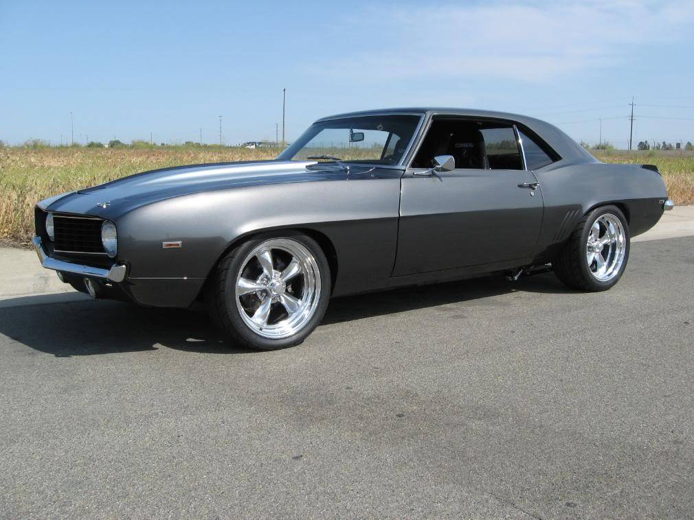

      Sauna, these are going on my '69. I can order as many sets as you wish, however. 10s will fit fine on a 67-68 also, just use a 275 wide tire and maybe roll the fender lips to be safe.

      Really? I got told I could only use a 9 or 9.5, **** this opens a whole new world, lol. So do the ones in the pics have a silver face, or brushed/clear coated?

      The ones posted above are brushed faces with clearcoat over them. The lips are polished.

      Do you run Wilwoods up front? It's not clear in the picture but it seems the bearing cap is sticking out of the center of the wheel. Does the center cap covers the bearing cap? Looking for proper wheels which solve this issue.

      Pics are shown without the centercaps, as they showed up a few days later. The caps cover the bearing cups.

      so I can get these, run them 18x8 and 18x10 on 67 camaro, 4.5 front bs and 5.5 back bs, and just roll the fender lips? I have Wilwood SL6 13 inch front brakes, that an issue?
