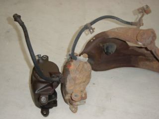

      Here's a comparison between a Monte Carlo (Left) caliper and a stock Camaro caliper (right). The 69 hose comes out near the top and has a clip that bolts to the upper A frame lip just back from the ball joint. You can see two holes, one for the bolt the other for the clip to hook on to keep it from rotating.
      The Monte Carlo caliper has a hose that is shorter and comes out at the bottom of the caliper.
      I used the Monte Carlo caliper on my 67 but the brake hose caliper fitting rubbed my bump stop a little. 67 bump stops are different than 68, and 69 is different again.
      For ref, the "stock" brake hoses on a '69 camaro (and I'm assuming a 68-74 nova?) are 16" long, so you'll probably need something in the 18" range. Probably over-stated by (everyone?) but consider braided hoses if you have to replace them anyway.
