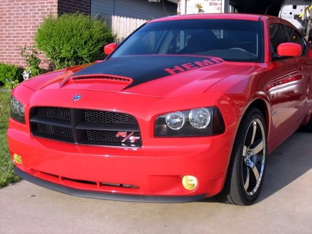

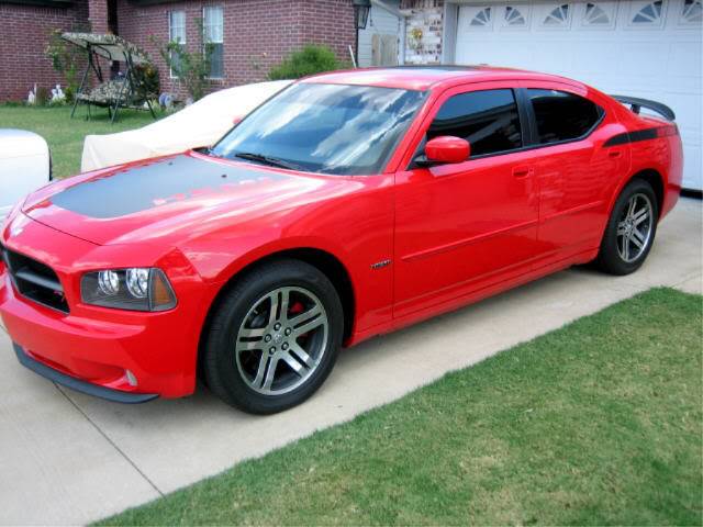

      Thanks for the replies, I went with a SEM bumper coater black to get the effect I wanted.
      Factory Hood and Vinyl graphic:
      New Hood with Bumper Coater to emulate factory vinyl graphic.
