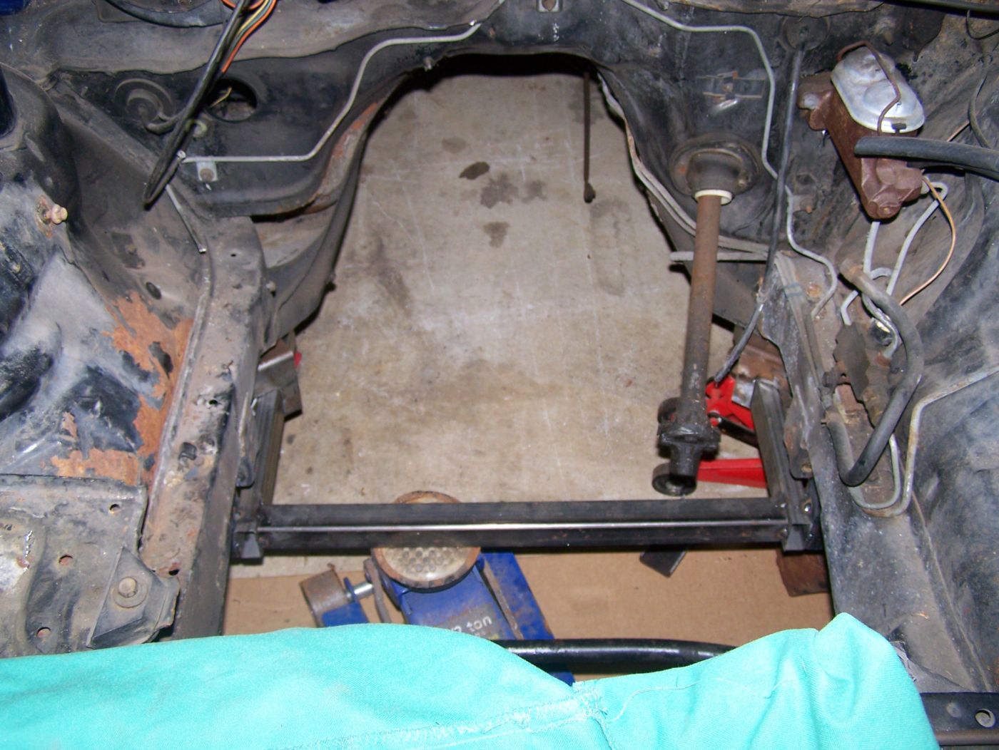

      I am excited to have been introduced to the site from Jalopnik and the post on the ecotec turbo Chevette. I am getting into the finer details of the build and really need a hand on suspension and anything else anyone is willing to offer!
      I am using the 4.9l PFI V8 out of a '94 DeVille. I chose this over the newer 4's and V6's available because the engine makes good power(240hp 300lb/ft), is only 50-60lbs heavier than the 4 I took out (360 lbs), and it is relaitively basic from a fuel injection/electronics standpoint.
      I will post a thread of my progress somewhere when I figure out where it goes, until then, here is the new front k-member with the other pieces being mocked up before welding.

      moving along, will need to move the thread
      My inspiration came from the fiero folks, the fiero weighs so little that an extra 50hp is a real kick. I like how they used the oem powertrains to get the power with limited modification.
      I think the chevette may be even lighter than the fiero, I think this car may weigh right around 2000lbs; the original engine was 65hp/98ftlbs.
      In any case, here is the front suspension all tacked-up and in for a test fitting. Don't worry I plan on gusseting everything real nice because it is rather spindly right now. I plan on using a Monte Carlo type brace but it is easier to do it and take pictures rather than explain it all here. . .
