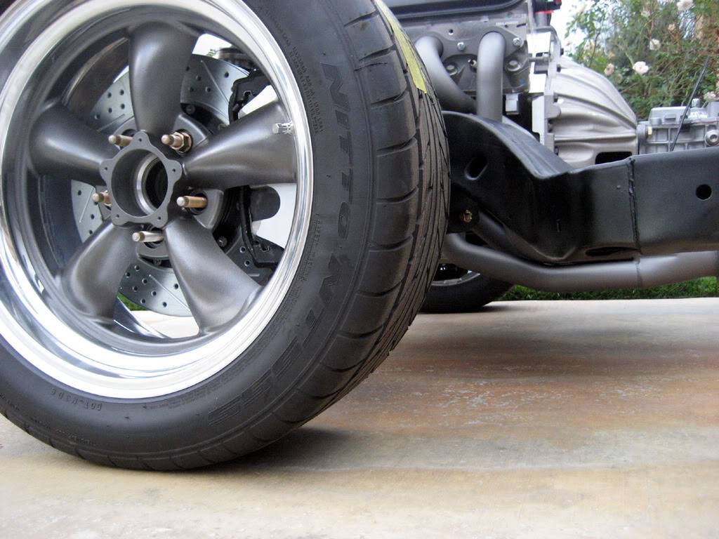

      Whoa hold on a bit now... I'm running the ATS spindles with Baer GT (C5/C6) brakes and they fit inside my $950 per set 18" Coy's wheels just fine. I did have to use flush valve stems with these wheels though...
      Terrible picture, but it is proof that it works...
      Are they the wheels that I will run on the car forever? Certainly not...but they will work until my budget shifts to accomodate a set of forgelines or whathaveyou...
