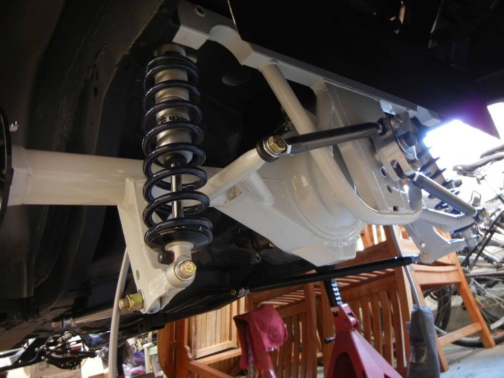

      In this update I'm wrapping up (blessedly) the rear suspension install.
      If you've not been following along, this is the Lateral Dynamics 3-Link System. Sadly, the company went out of business a few years ago so here's hoping nothing ever goes wrong with this damn thing or I'm hosed.

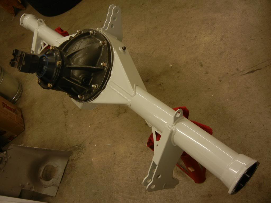

      Matt Rogers did all the fabrication on these and I'll be damned if I've ever seen better fitment and welding. Broke my heart to cover it up in powder coating.
      As you can see, I had the housing powder coated in a light gray to aid in spotting any leaks or cracks down the road. The 3rd member is a Strange (iron) 9" with 3.70 gears and a Detroit TrueTrac diff. Should be plenty stout.

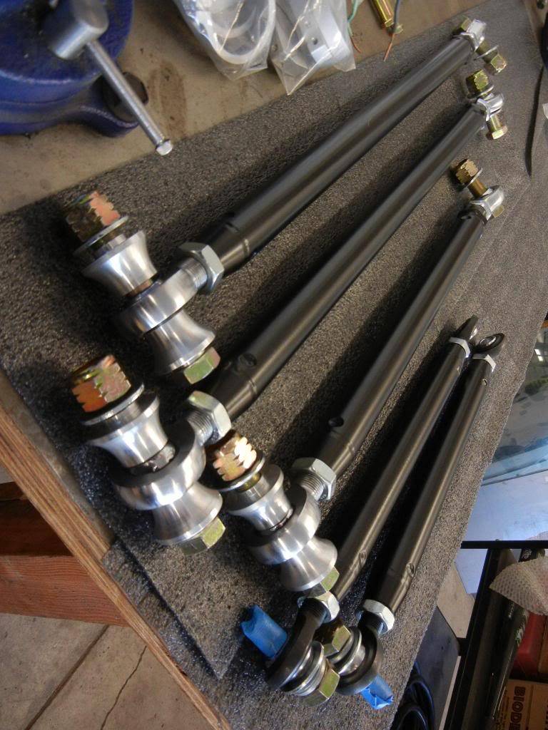

      The hardware in the system is all really top notch as well. I sure wish the manufacturer was still around, I'd love to have a list of the rod end sources and PN's for replacements if needed.

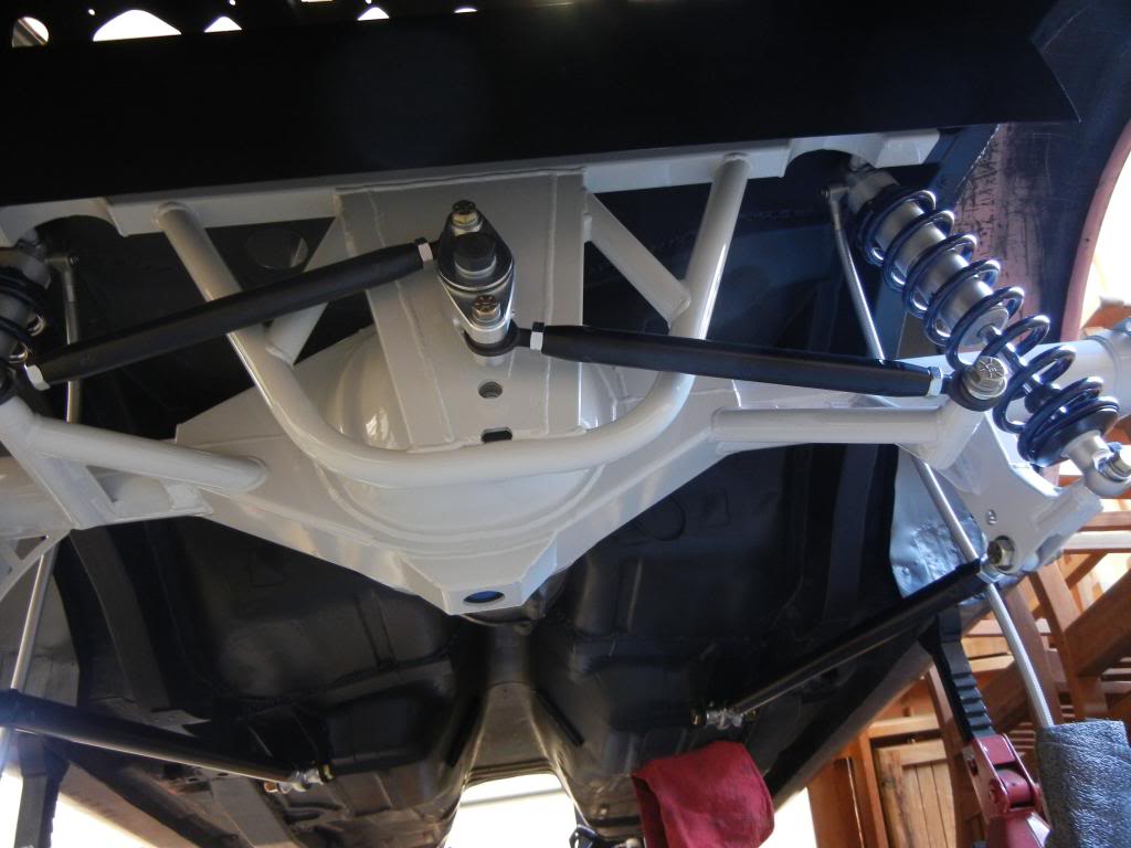

      The install of this system was the most challenging part of the build thus far. I went into it with my eyes wide open on that and thanks in large part to Matt, David Pozzi and James Shipka I got through it. Here's hoping the performance potential of this system over some of the more "plug-n-play" bolt in kits makes it worth it.
      As you can probably tell, the rear alignment is way off. Not worried about that right now. But I'll get it in the ballpark before it rolls out of the garage at the end of this month.
