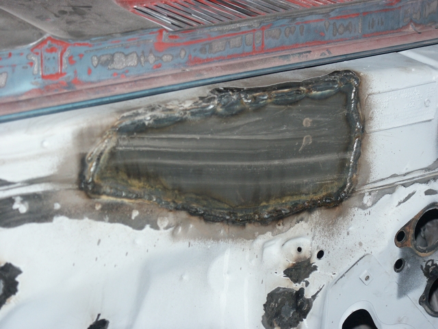

      No picture now, but that's how we did mine.
      Welded the seam, uneeded holes and filled the heater box hole w. 16 ga.

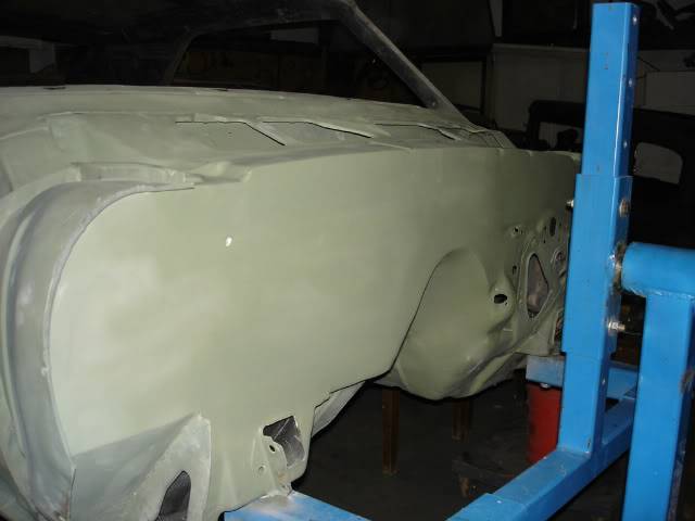

      i did the firewall on my truck 3 different way's.
      1st way was to just remove the old ac box
      2nd way - try to smooth it a little more
      3rd way - way exactly like i wanted it

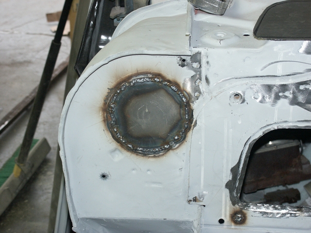

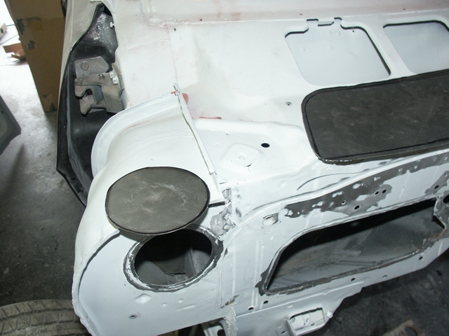

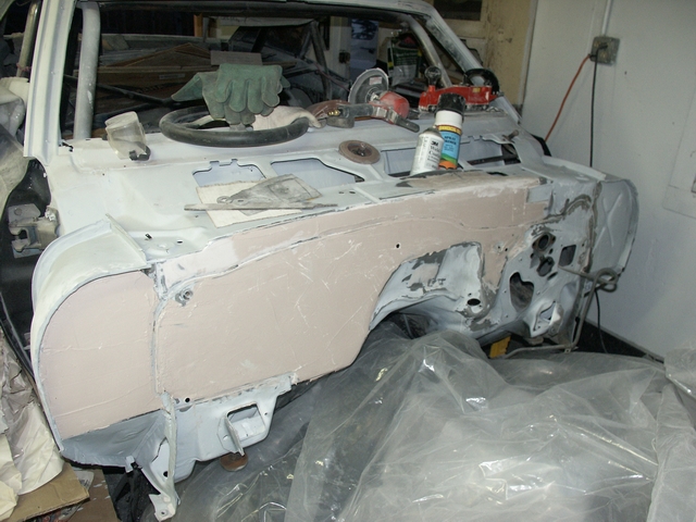

      I made little fillers on mine and welded them in to the blower motor and heater core holes along with the windshield wiper hole since I moved it inside the cowl. I also welded in smaller pieces of metal in to the bolt holes and any other hole that was in the firewall that I wasn't going to need. I had to straighten out the lip around the heater core hole with vice grips, a body hammer and dolly. Once I had the pieces in and ground smooth, I skim coated with body filler. I left the line between the firewall and cowl section because I think that a totally smooth firewall looks a little bland to me.
      Wiper motor hole:
      Body filler before sanding:
      Finished and painted: (seam sealer dried a little to quickly so It's a little rough, but not bad)

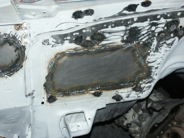

      Hey guys, this is my first time to post and I may be to late, but attached are several pic of smoothing the firewall on my 68. I also had to modify my tranny tunnal for a T-56 as well as make it look a little better. To cut down on vibration, I welded in several places through the existing firewall to the new one to tie them together.
