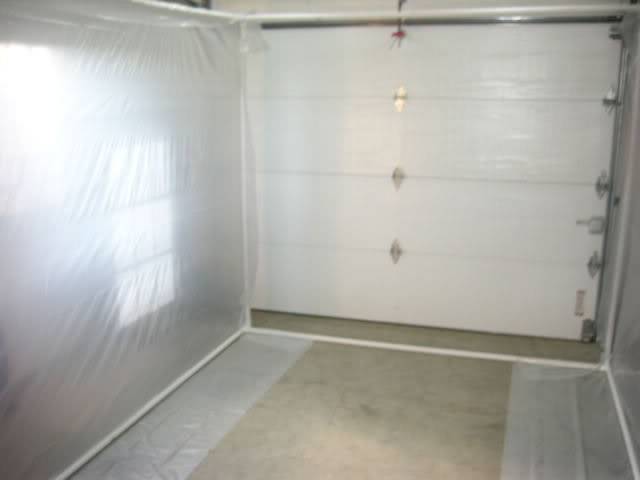

How to build a paint booth in your garage without pissing off your wife
Well I lied about pissing off your wife. My wife is still upset that she “did not get her garage back” when I sent my car to a local body shop. Now, when she complains about me spending time in the garage, I remind her that the sooner I get done the sooner she can get the garage back!

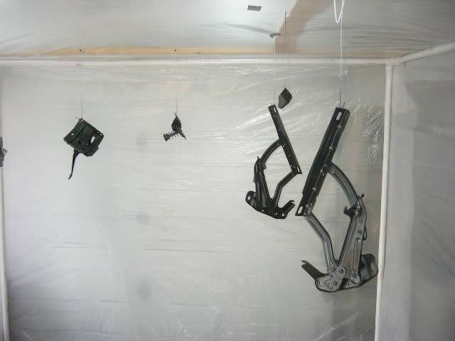

I spent about $75 dollars in materials and it took about 4 hours to build. I am sandblasting and painting all the small parts instead of paying someone else to do it.
I have used the paint booth several times over the past two months and it works great! It keeps the fumes from getting into the house and I don’t have to worry about dust, bugs, dirt getting and the kids touching the wet paint.
Materials:
· 4 x Roll of clear plastic 8x10'
· 2 x cans of aerosol spray adhesive
· 8 x 8' x 1" PVC Pipe
· 4 x 10' x 1" PVC Pipe
· 8 x elbows 1"
· 8 x T connectors 1"
· 1 x can pipe dope
Below are some pictures:

another way to do it is to get a cheap ez-up and line the sides with plastic. Not bad though for home built ingenuity :thumbsup:

what did that cost you to build? thumb up.
03-26-2008 #4Looks identical to what I just built, worked great, easy to disassemble. I used a box fan for air flow out of booth. Excellent idea!
Later - Craig

03-26-2008 #5Right on! I also hooked up a small fan to vent out the fumes
