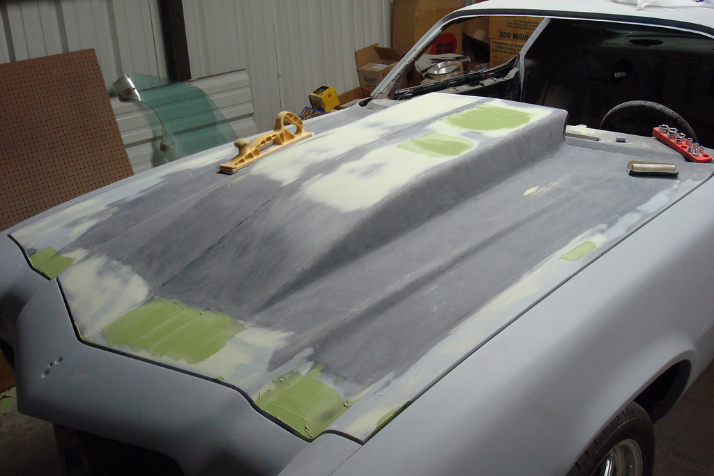

      Did the hood today, the weather finally worked with me and I was able to longboard the hood and to my suprise it is very straight for a fiberglass hood.. I only had the put filler where I had made the lines tighter and the cowl and that is it. The little inperfections will be filled with this Slick Sand product that I use on everything that is fiberglass around here.. It is a Very High Build Polyester Filler..

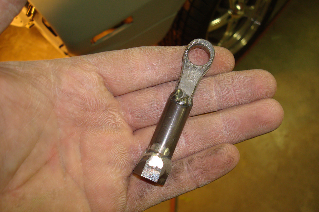

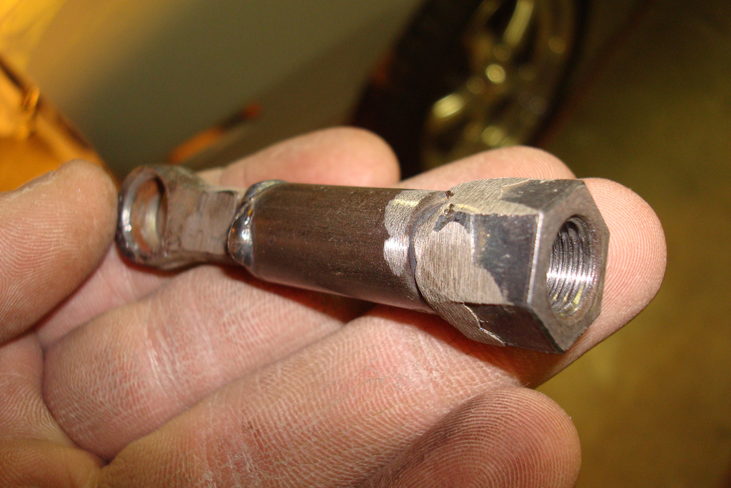

      I also decided that buying a kit to make my late Model Booster work with my pedal assembly for 65 bucks was pointless. So I made one out of my old Booster rod, peice of thick wall steel tubing, and a fine Thread Nut.. Worked Great!! What do you think??
