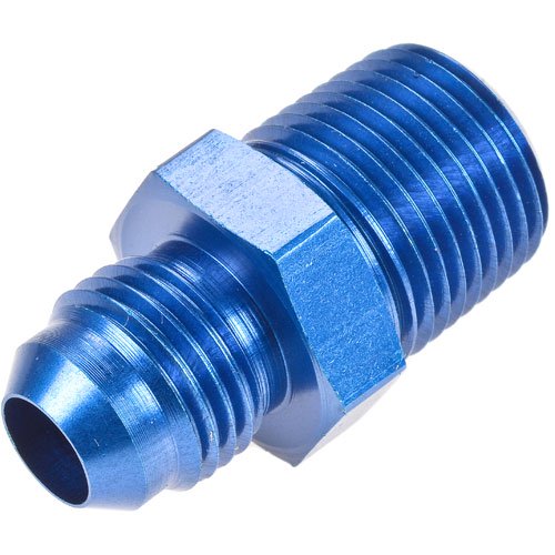

      Not sure about the 5/16, but if you convert to 3/8, you can go with any assortment of -6AN. I don't see how you can do this in one step though...
      http://www.jegs.com/p/JEGS/752558/10002/-1
