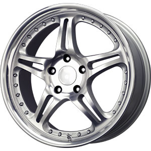

      Wheel and tires, Front 17x9.5 with 275/30-18 and the rears are 17x12 with 335/35-18. Front tires and wheels will be delivered today. I will hopefully post up some pictures tonight. They were cheap one piece wheels and I’m having the rears widened but they look a lot like the HRE 547.
      Here are the wheels I bought.

      Where did you get the wheels at and how much did they cost/

      I bought them from Discount Tire Direct for $145 each. They come in 20mm and 35 mm offset. I'm very happy with the quality and cost. Most people that have seen them in person mentioned that they would have thought I spent $1500 for the set.
      I will post up some pictures soon. I went to take some pictures and our camera was dead. It appears that it may have been dropped, the case was separated at the corner. I did take some with me Palm phone but I am having trouble finding the cable that connects to the computer so I can download them.
      http://www.discounttiredirect.com/di...w=9.5&bp=5-120
      http://www.discounttiredirect.com/di...&rw=8&bp=5-120

      How much do those wheels weigh (wild guess is ok, they've got to be better than my Soft 8s)?
      According to my bathroom scale 27lbs.
      Hrm. Thanks for weighing them -- but I would have thought they'd be lighter. Is that the bare rim, or did it have a tire on it?

      Bare rim. I'm ok with it, they were way cheap ($145 for a 18x9.5). If funds would of allowed I really would of bought some Foregline ZX3S, oh well maybe another day.
