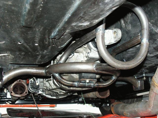

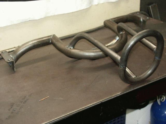

      Not something that I bought. I (or I should say my roommate and I) made mine and integrated it with the transmission crossmember that I built for my T-56 install.
      On the bench before installation:
      Installed on the car:

      That is tight!
      Check out the new PHR, Steve had a great idea with a "generic" loop on the Fairlane.
