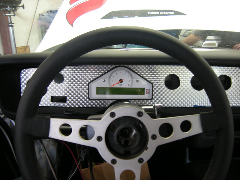

      Fitted our amazing STACK dash unit with a few other STACK gauges in a custom turn-polished dash (with matching door cards and shifter plate):
      DSCN9625 by Schwartz Performance, on Flickr

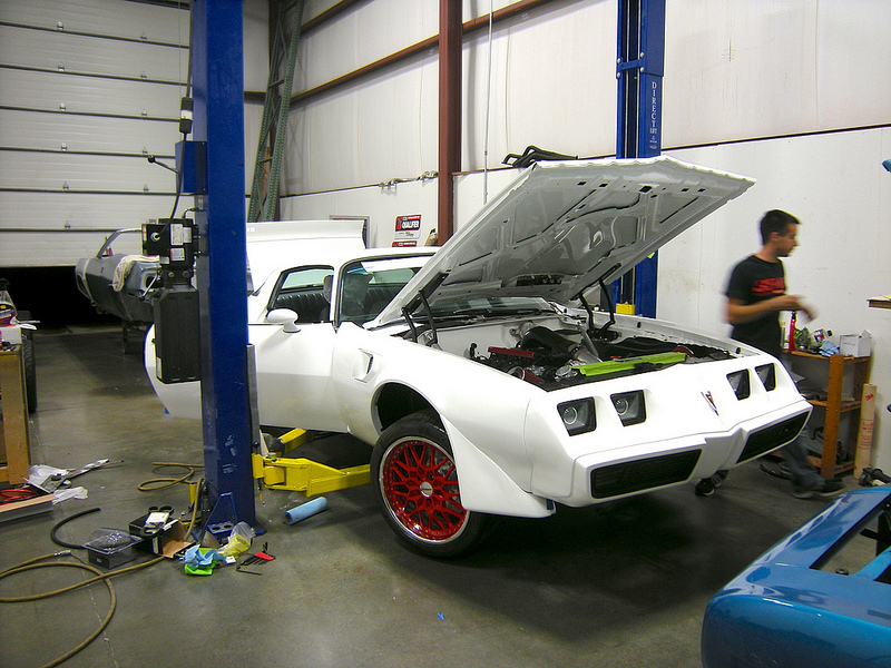

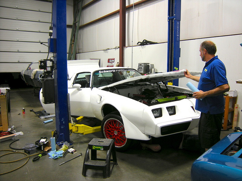

      Jeff Schwartz closing the hood finally!
      DSCN9637 by Schwartz Performance, on Flickr
      Painstakingly applied the obligatory Schwartz Performance windshield banner:
      DSCN9644 by Schwartz Performance, on Flickr

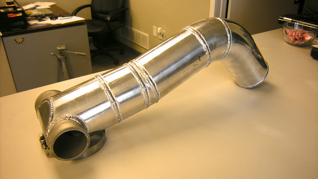

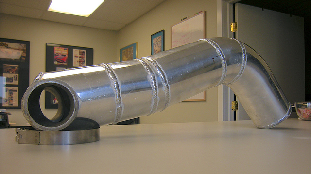

      Check out the intake tube Jeff designed... Both intercoolers feed into each end of this. To help the air make the sharp upward turn, Jeff used two 90-degree Vibrant pieces (cut down to about 45), which you can see inside:
      DSCN9627 by Schwartz Performance, on Flickr
      DSCN9628 by Schwartz Performance, on Flickr
      And finally, the 1010hp twin-turbo LS9 engine. We've played around with a few intake options and finally deciding to fabricate our own. We're still going to powdercoat all the piping. Everything will be black for a simple OEM style. The whole feel/vibe of this car is understated style, luxury and performance.

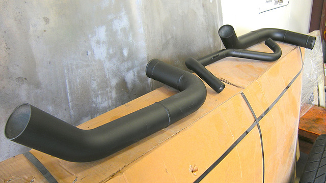

      Tiny update, but we got the intercooler piping back from powdercoating. Jeff decided to go with satin black.
      Powdercoated Intake piping by Schwartz Performance, on Flickr
