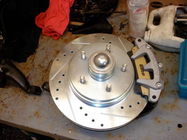

      those calipers look like the same ones I have on my b-body spindle swap.
      dave.t
      74 Javelin AMX - stocker
      33
      They are Wilwood GM III calipers, How long have you used them and how well do they work on the street? Keep them Olds running!!!!

      i only have a couple thousand miles on mine, and no real racing/autox time, but so far the do they job. and look cool.

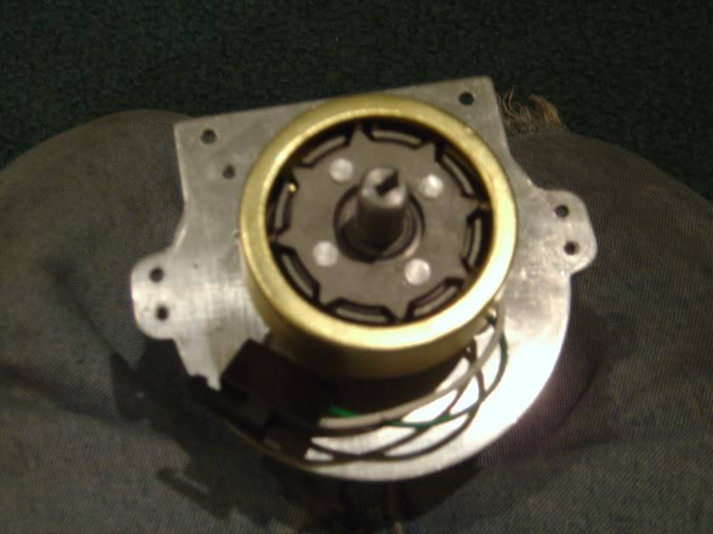

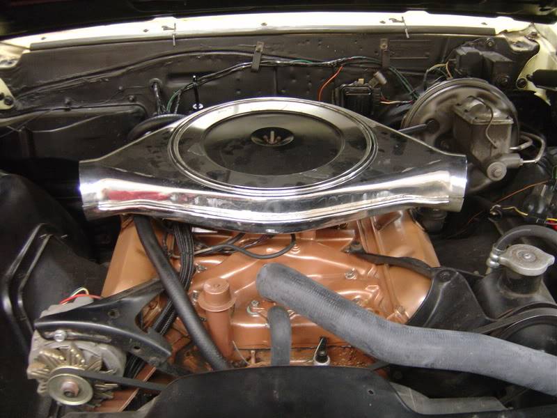

      One thing I wanted to point out is how I tried to hide the fuel injection from unknown lookers. I had a small cap HEI distributor cut in half and connected to an Olds lower distributor so no one knew I was controlling the timing w/ a computer.
      The distribuuor on the left is a new Chevy small cap distributor and the one on the right is my creation. I did this because Olds never made an electronic distributor so instead of modifying (which would be easier) a big HEI destributor I make my own so it would look like the original distributor. I basically made my own cam sensor so the computer could calulate the timing. Took a little time to get it right but it works like a charm. This bit is also nessicary when it came to tuning this Holley system. Couldn't get the fuel maps right w/ out the timing working in the computer. When I first installed the FI it was only the fuel and the distributor was running on petronix (could have used points).

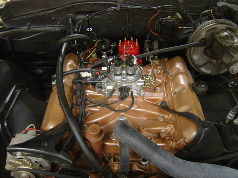

      looks awesome so far. too bad you can't hide or mask the connectors on the pass side of the TB.
      is it running yet?
