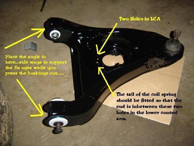

      Question is, on a set of arms that have the poly bushings already in, can I swap them out for DALs?
      Rustburg, Virginia
      3,436
      Quote Originally Posted by Tony_SS
      Yup, that's what I did...mine were still in good shape, I just heard the rave over the Delalums and swapped them out and I am glad that I did. It will probably be easier now that you have had bushings pressed in and out a couple times. While I had my lowers off the car painting them up, I pressed the old poly out and had the new Delalums in about 10 minutes per side. I used a 20T hydraulic press, but you can do it other ways....
      ....just make sure you support the flanges of the control arm so that you don't bend them....here is a pic that might help you see what I'm talking about:

      As long as the bushing housing (holes) were not damaged, I say so. The DAL's replace the stock bushings.
