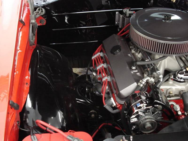

      This is a panel i made for my firewall when i installed Vintage Air in my chevelle. Made it from sheet metal, bead rolled some line's into it and painted. I used 3M 5200 to glue it in place and screw's thru the coil bracket. Working today on one for a friend's chevelle. Doing this with the engine in the car and only pulled the distributor.

      Quote Originally Posted by wayne70
      Who makes those wire looms?

      Quote Originally Posted by 67speedfreak
      I have a set on my truck and really would like to get another set for the Camaro.
      I can't seem to find them anywhere.
      Thanks for the help.
      Brian
      I think that are made by "Made For You". Summit carries them, http://store.summitracing.com/egnsea...=KeywordSearch
