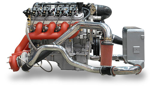

      APS uses cast manifolds :
      and I believe Turbonetics....but good luck trying to get cast manifolds for a reasonable price.
      Matt has the best idea of trying to get a stock type manifold to work. There are also a couple of companies successfully running a Single turbo on an lsx platform--using a cross-over pipe. Not the nicest looking set up but somewhat affordable.
