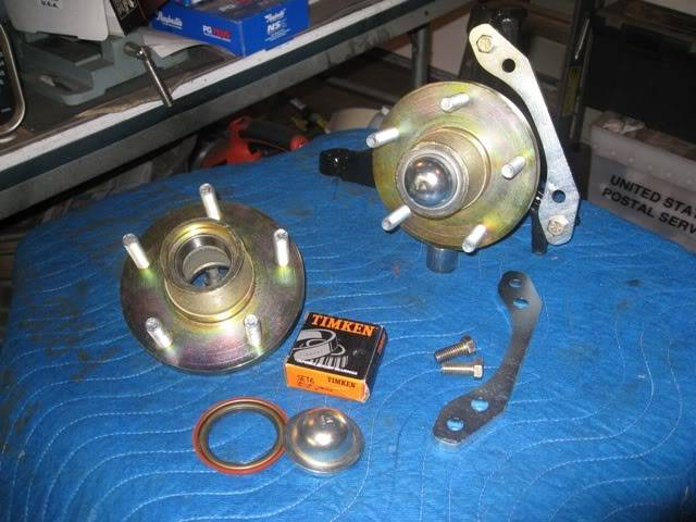

I have brackets available for the LS1 setup as well, laser cut and zinc coated as seen below. Hubs are zinc coated and have longer studs installed for you. I can do C5 brackets too:

So do these kits work with say a drop spindle? cuz if I was gonna go and take my front end apart again I'd go with the drop spindles this time.

Dropped spindles work fine with these type brackets as they mount to the dust shield bolt holes which will be in the same locations on stock or dropped spindles, IE a 2102 BT dropped spindle.
