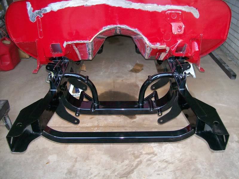

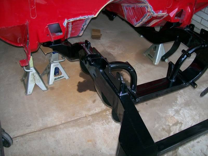

      Here are some pics of the 1968 Camaro I'm still working on,I mounted the Art Morrison frame along with the Z06 6-pistons calipers.I started installing the dynamat,this weekend I'll be wiring the entire car for mock-up.Ill post more pics later.Its soon going to sport a 408ci with a Kenne Belle. If anybody wants any kind of LSX work hit me up TEAM LSX Performance.........
      Frame Installed
      Dynamat first layer
      Billet Aluminum black anodized body mounts

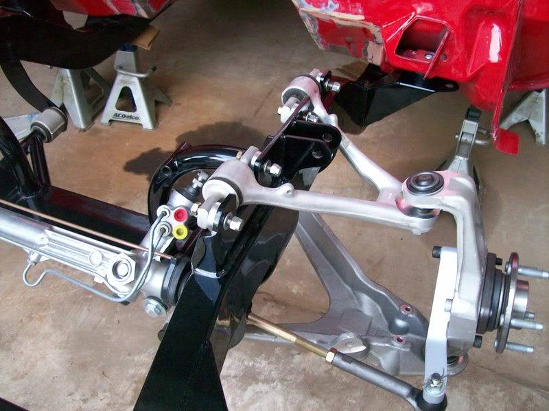

      Corvette Z06 front suspension
      Z06 Corvette 6-piston brakes "It should brake"
      Cant wait to feel how the car is going to handle!

      looks great, but why is the chassis in with all the bare metal on the firewall and tunnel area?
      also what kind of lsx work does your business do/?
      Laredo, TX
      66
      He's just doing mock-up. Cars got to get prepped and painted yet.
      1,027
      cool, just kinda sounded like he want putting it together, not mocking it up, nice work

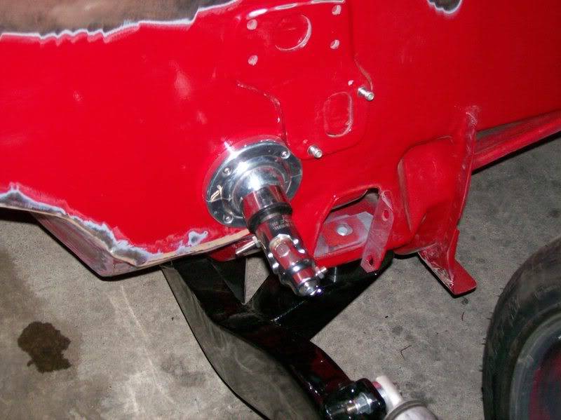

      BTW, you have the uca arms bolted on wrong and the spacers on the wrong side

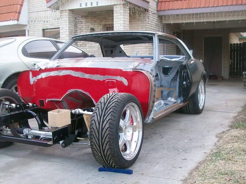

      The control arm I knew about ,already fixed it here are some pics on the ground...

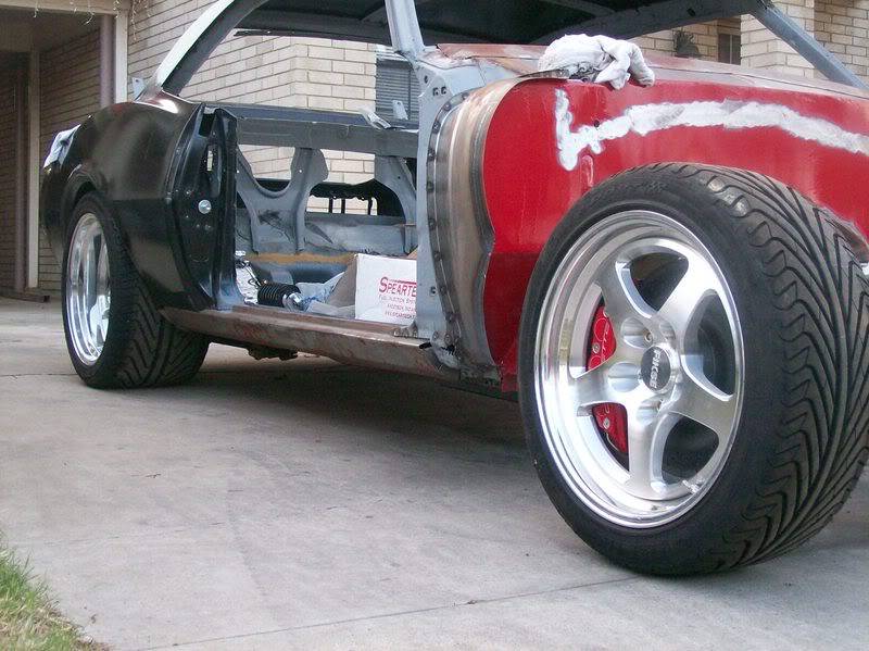

      Couple more pics on the ground,mounted the Fiske wheels and the steering column.
      1,027
      looks great, who's collar did you use for the steering column, on the firewall?

      It's from Flaming river, I have tha same one.

      What size of wheel and tire are you running?
      Kevin
      14
      yeah x2 to know what wheels you are running and sizes ?? they do suit it well.. but a very tight fitting up the front!

      They are Fikse FM5's

      Why did you have to modify the trans tunnel? Is it because of the AME front suspenstion or are you using a Viper trans?
      Looks Killer. I love seeing '68's get the treatment.

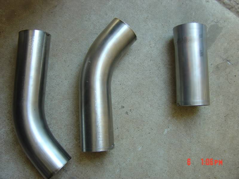

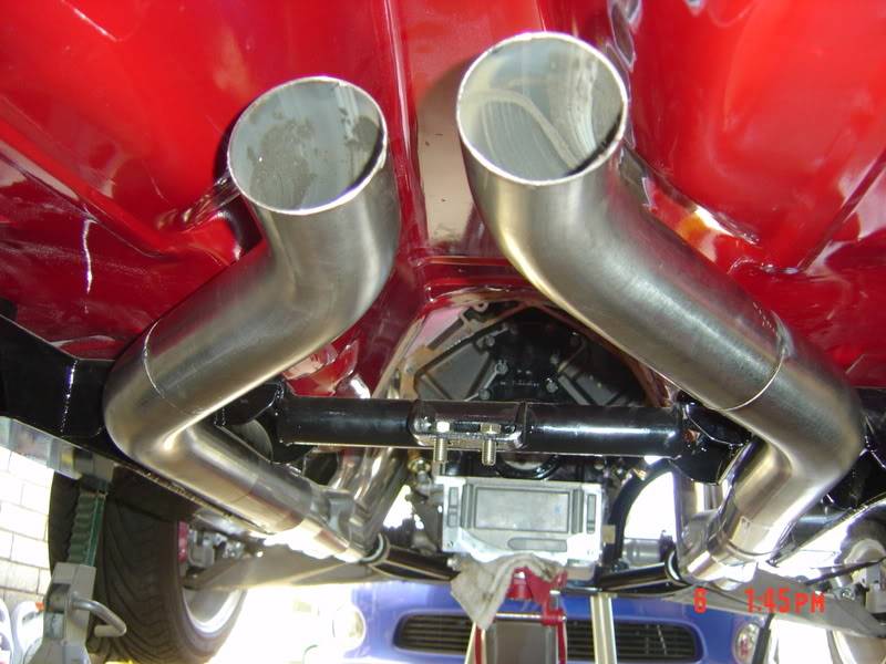

      Little Update:304 SS mandrel tubing
      Exhaust work
      Tack welded
      Trial fitting

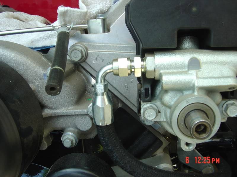

      Made power steering hose
