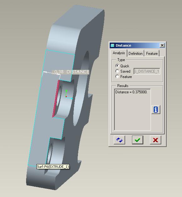

      Steve,
      Hey, I replied to your PM on camaros.net. Here are those dimensions I promised you. Take a look at these and tell me what you think. In my opinion, I would make the bracket for the clutch out of 1/8" plate (I have ATS' plate for the T56 on my firewall and it is 1/8 thick) and I can easily make the counter bore a little deeper and would probably do so for all of them. If you go another 1/4" on my counterbores, you will be left with an 1/8" of aluminum.

      Leave the bracket as designed. I'll either install longer studs or use 1/2 nuts depending. PM with price and we'll make arrangements for shipping and payment.

      441
      Is the locating "nub" in the center bore at the 9 o'clock position something that could be changed? I am going to run a Cobra H-boost unit and I think it is clocked differently.

      Quote Originally Posted by bretcopsey
      I don't see why not. Can you verify which way the unit is clocked and where the locating pin should be?
      Nick

      Nick,
      I didn't realize that you are doing all of this work on the bracket.
      I think that a 15 degree pitch the the others are talking about would really help. I can get you pics of my entire setup.
      The bracket that you sent me seems to almost make the hydroboost point down. It makes the proportioning valve and lines of a stock setup interfere with the inner fender.
      I will get you pics of everything today including how I made the system work with the stock clevis.
