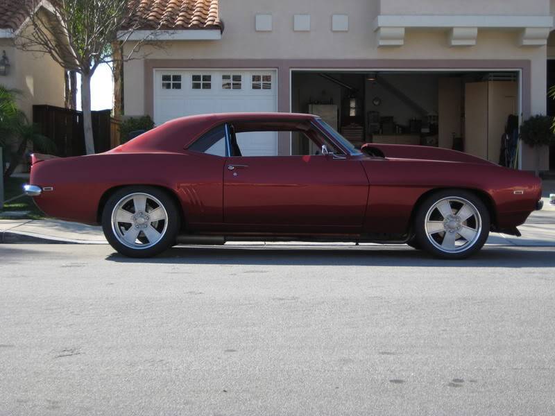

      A sweet set of these in an 18/19 combo, or 19/20 combo would be perfect. We can build them to fit, and get the widest tire possible under that car, front and rear.
      It's called the "Rated X", here shown with a brushed and cleared center section, and polished rim outer.
