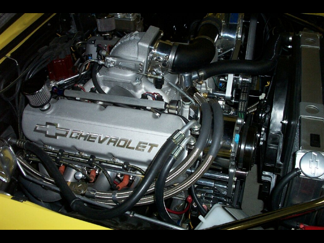

      As far as the tensioner/idler pulley setup, Jody (camcojb on this board) turned me onto Scott at SDCE in Rhode Island. The idler setup is something Scott came up with years ago and sells the crap out of because of all the problems with Procharger's stock setup. It works extremely well, other Procharger guys with stock setups usually can't believe how many miles I have on my belt... and an 8-rib at that! Last time I called Procharger to order a different pulley the tech guy questioned how I was getting an 8-rib to work at my boost level until I told him I was running one of Scott's tensioners... at that point he chuckled and said "yep, that will do the trick." Even they know about the shortcomings with their own setup as much as they don't like to admit it.
      Here's a pic:
      http://home.comcast.net/%7Eprocharge...belt_setup.jpg
