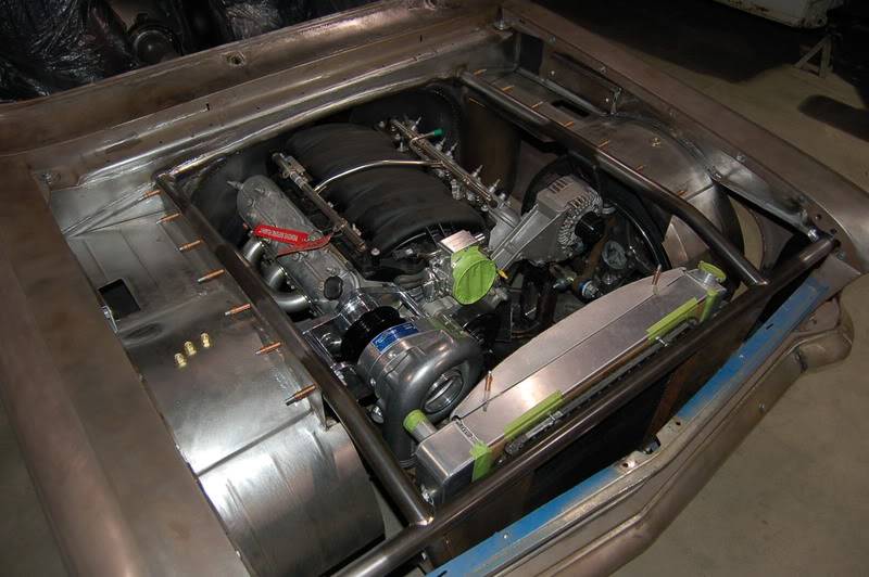

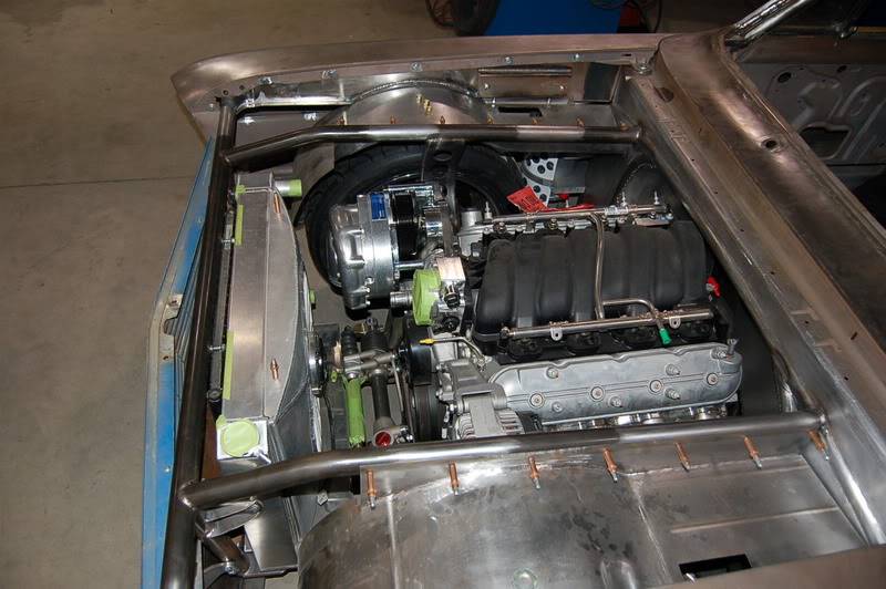

      Rodger and a friend were screwing around in the shop today and his friend had suggested to him that we should put a blower on the LS7. Rodger felt that it wouldn't fit but for $hiznit$ and giggles he had a Procharger laying around and decided to see what it would look like or if it would even fit.
      It fit! DAMMIT! LOL!
      What do you think?
      What to do, what to do!!!:D
      Adding a blower will add an additional 150 hp which would bring total HP to 650hp. For street that is a hell of a lot of HP to be responsible for! The car will be all over the place with that kind of torque and HP but DAMN it sure looks snug as a bug in a rug where it's at. It seems to have just made itself at home there! LOL!

      i say no your car seems to be set up to be one hell of a road racer and the blower will not be good on the course. besides everybody has a power adder now a days, just put a nice set of heads and a cam and you'll have almost the same numbers and a nice soundtrack.
      FINALLY!!! Someone to talk sense into me! LOL!
      You are right in that a blower would not help me out on the track! Something to definitely consider! Thanks!

      i read from Gm that the reason the Ls9 is a supercharged LS3 and not a supercharged LS7 is the the cylinder walls on the LS7 are to thin to run good sized amounts of boost without problems....
      dont know how true that is, but u might want to look into that before u decide.
      id say go ported heads, headers and a nice thumpy cam, that should easily put u over 600 HP

      looks like a snail crawled up and found a home..
      i say DONT do it.. hahaha

      Thanks for the knowledgable and insightful responses! In as much as it looks really cool and would definitely add HP I need to keep my focus on what the car is being built for and track use is definitely a high priority so I guess no blow!

      Bad move! Leave it N/A for track use! Add a new cam & a tune to the motor and go run around with it. You can always add a blower later but I would suggest leaving it N/A for track use.

      If I understand the mechanics of the LS7, they flow really well and you don't gain much by a blower. Correct me if I'm wrong though. So if your not going to get that much gain, Why do it?
      Feb 2006
      SoCal
      1,622
      Quote Originally Posted by cmraman
      The blower would add just that much more density to the air already flowing into the motor. The problem that I see is more in the block itself since the cylinder walls are fairly thin and adding a blower would add stress that the motor may not be able to take in its present design. The new LS9 has been speculated to be either a blown LS7 or a blown LS3. Consensus feels that it is probably the LS3 because of the issues that I mentioned above. Have they blown LS7's? Sure, but you have to be very careful about detonation in the motor when your tuning it. I would need to find a shop that has a lot of experience in tuning LS7's since most dyno shops are setup and have most of their experience tuning 350's. 58x reluctor, finding correct TDC these are just some of the issues that would need to be sorted out and dealt with and if the shop is not experienced enough it could lead to disasterous effects! Not to say it can't be done but is it worth the time, trouble, expense and chance that something could go wrong?!?
