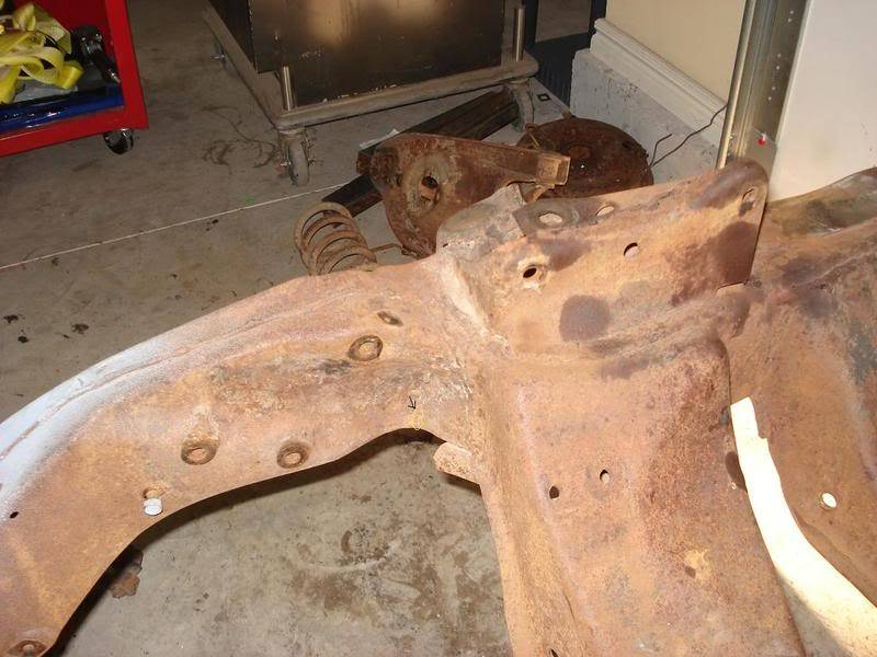

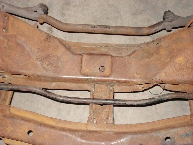

      I tore down my stock subframe and notice all the oops that have happened to the subframe over the past 40 yrs. I have a couple hairline cracks, which I'm not to worried about. I'll probably just grind a groove in the cracks and then have it welded up. Then only real concern is a pretty big dig/dent in the frame. I was wondering what would be the best way to fix this, what about heating it up and then hammering it back in place? Here are a couple pics of the dig/dent and a couple of the cracks (close up and far away of the cracks).

      sorry to say but that area is bad. The direction the dent and location of the crack might indicate the frame being tweeked.

      Due to that heavy of a hit, I would be on the lookout for a donor subframe from another nova or camaro. I dont believe that you can hammer from the inside of the frame.

      If you keep the sub make sure you "stop drill" that crack before welding.
      Stop drilling is where you drill a hole at the end of the crack to effectivly stop its travel. even if making a weld repair it could still resplit and travel.... Crack ---------------O <"stop drilled" hole

      Short of the impact on looks I wouldn't worry about the dent at all. Just put a tape on it to check that it's still square.
      That said, I would be VERY worried about the cracks. Just got to the yard and get another one. They're cheap and plentiful.

      i did frame work in a chevy dealership body shop for 20 years and it looks like the horns could have been knocked over. that is where they will bend at the crossmember. measure at the end of the frame rail and see if one frame horn is higher than the other.
