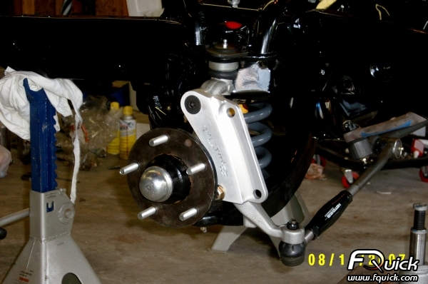

      Yes you do. My car had factory front disc brakes and when I did my big brake upgrade I got 69 front drum hub and turned them down so the C4 z06 rotort would fit over the hub. I used the disk brake spindles that were on the car.

      That is correct, however, speedtch provides the correct spacer for the upper boss. Everything bolted up perfectly.
