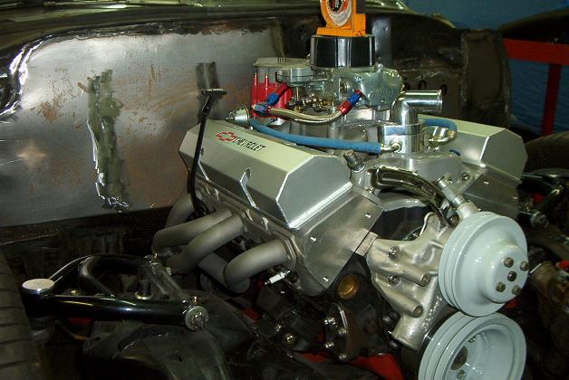

      Thanks..............I was getting little lonely. Uh.....the welder is one of those blue one's. Actually it's not mine. In the shop I'm working on it at there are two differnt size mig welders and a tig welder. The guy that own's the place is doing all the "Real" welding but I'm learing. All those crappy spot welds on the tunnel are all mine!

      Looks great. I like this one the most. Great idea.
      Whattya got for a motor?

      Do You mean the zip tie is a great idea? No upper mount yet......... :rolleyes5 The Motor is the same GM performance parts crate motor I've been running for years. This rebuild includes new Dart II aluminum heads 220cc runners, a fairly healthy cam that I don't remember the specs on and an edelbrock air gap manifold. Guessing it should be around 400hp. The heads are a bit large but the will be enlarged to a 406ci at some point in the not too distant future( hopefully with twin turbos also).

      Yeah--I saw that wire tie. Let me know how that air gap works out I want to yank the Victor Jr off of my 406.
