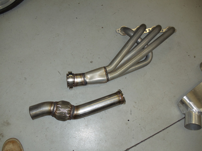

      And the GTO headers fit good? Reason I ask is that I'm considering an LSX for mine. Thanks.

      The GTO headers fit my chassis, in the end I did end up cutting them up and shortening the header at the collector. How they would fit a "REAL MUSTANG" chassis is anybodys guess.

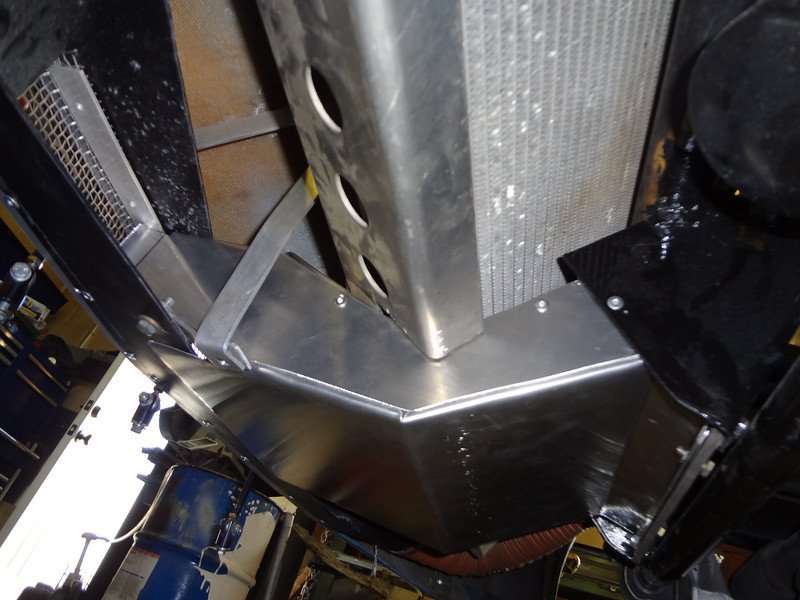

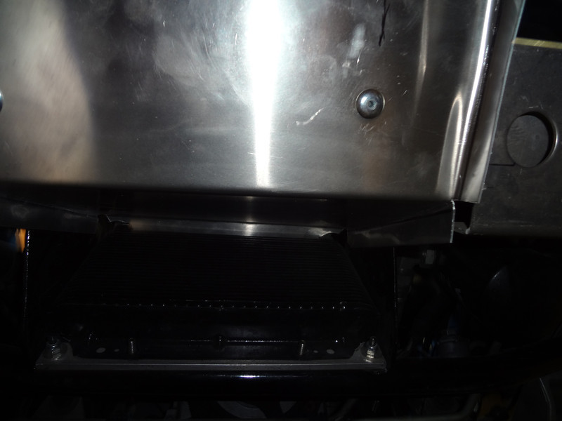

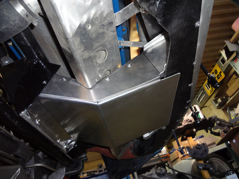

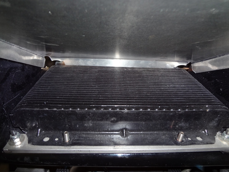

      Trying to get all the ducting fabbed. This oil cooler ended up behind the radiator due to the massive 12AN fittings on the cooler, and the difficulty getting the lines to it. Not the ideal setup due to the recycled after radiator air. I desided to build some duct work to plumb some preradiator air into the cooler, trying to get the air in there was truely a challenge. So the lower grill will feed the oil cooler, and brake ducts. Really hoping it makes a difference, and I don't see any 300 degree oil temps this year.

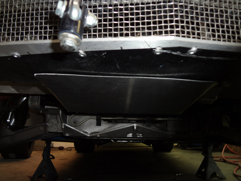

      The finished product. What a time consuming pain in the butt.

      Very nice Ron. Looks just like the shroud on my factory intercooler for the Buick Grand National.

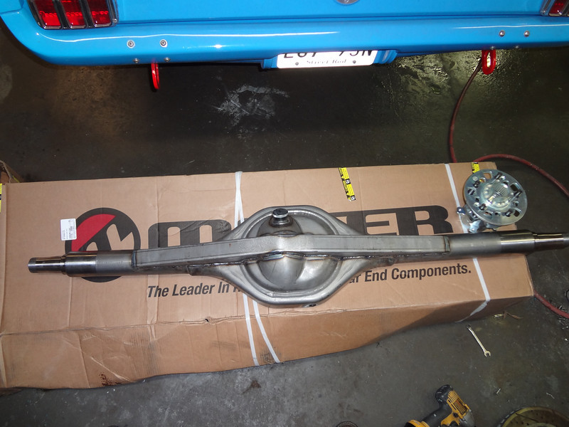

      Hate to wait to the last minute with RTTS in how many days?, so I just order the 9" rear today. After talking to CCW, I desided to run 5/8 studs.

      If you ever want to let loose of those headers, let me know!!

      What's the problem with that? My Elky/Schwartz chassis uses 1st gen Camaro headers. Fit perfect until I tried to run the steering shaft from the col. to the rack. Oops. Back two tubes right in the way. Little mod and the shaft has a nice tunnel thru the tubes.
      Get ready for the hate mail.LOL

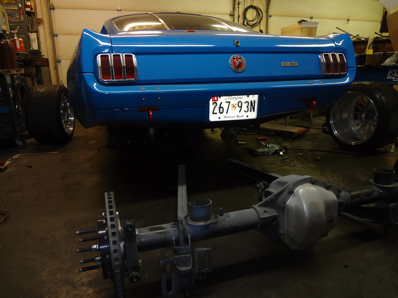

      I am still amazed that you can order a custom made rear on Monday, and it can be at my door on Friday. Floater showed up with all the mounts etc., I opted for the back brace due to the shear length of this rear, still alot lighter then the Dana. Will be getting all the brackets dummied up and welded on this weekend, then sending it out for powder coating next week.

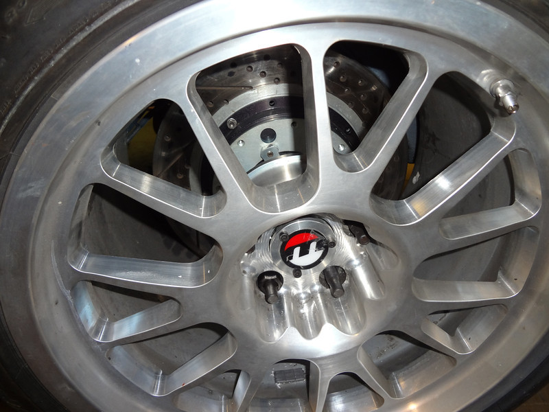

      The only thing I didn't like about the Moser stuff was 5/8" holes with 1/2" studs on the drive plates. After talking to CCW about the wheels, they said it would be no problem drilling the wheels for 5/8" studs as long as I used 60 degree lug nuts. The 5/8" studs are super tight to the drive plates, in fact I'll have to bang the plates on. I'm now temped to put the 5/8" studs on the front.

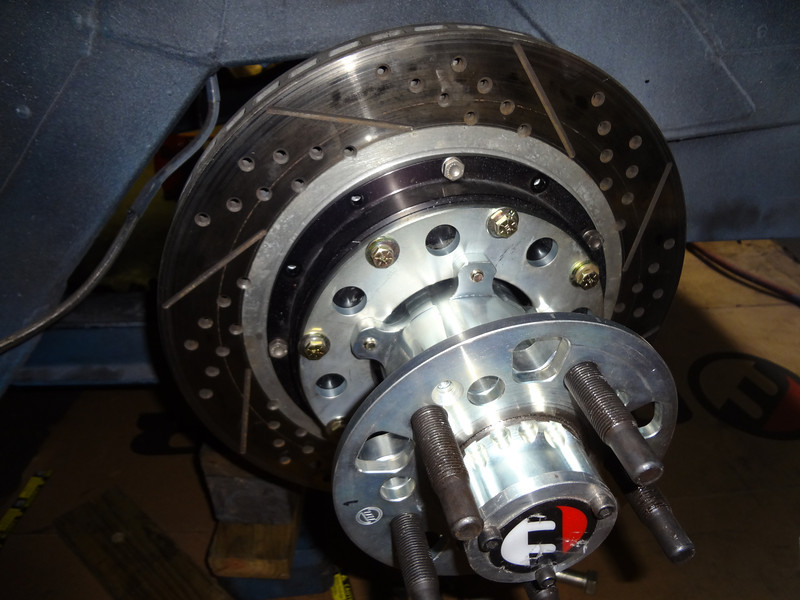

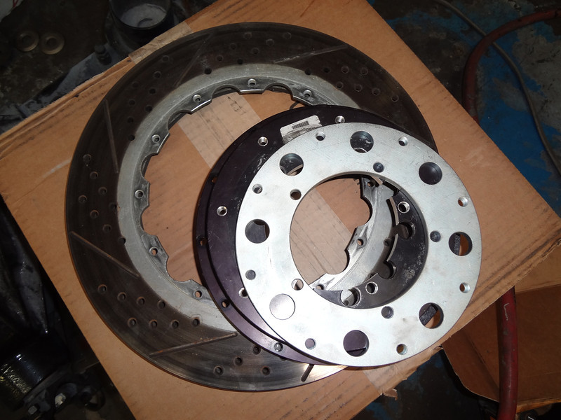

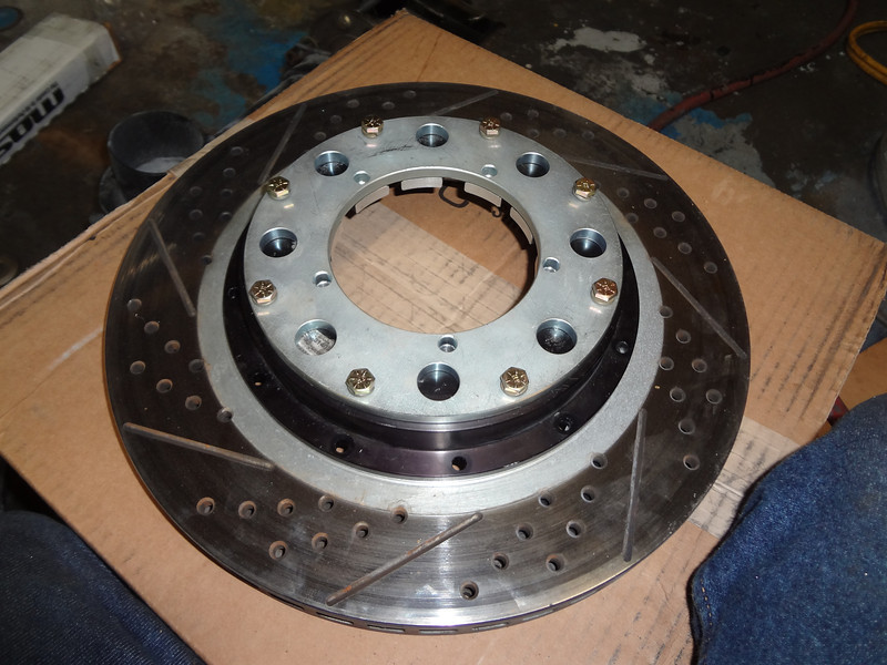

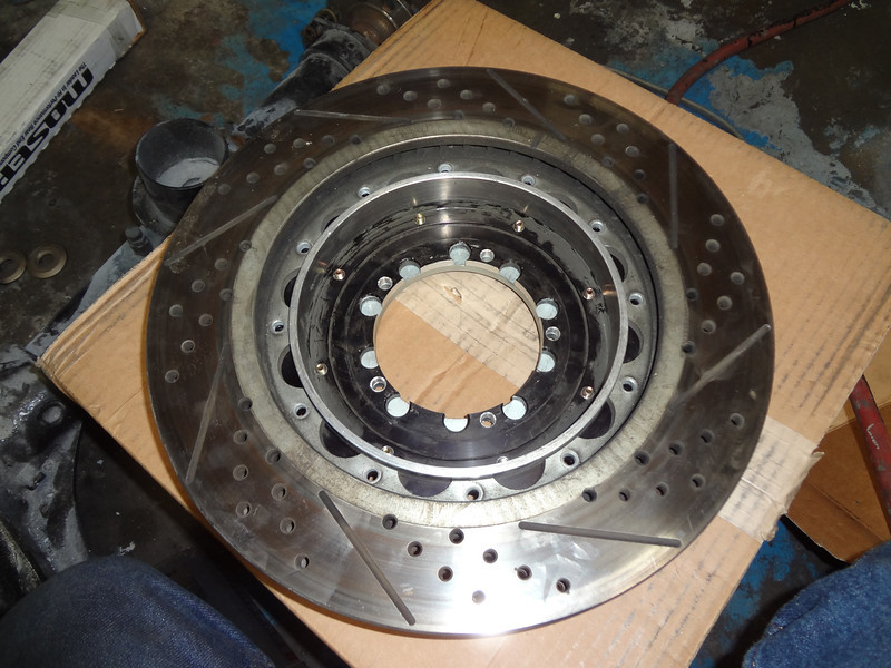

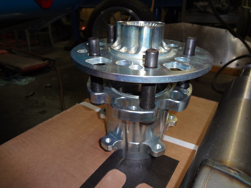

      Got the brakes mocked up, trying to use the Baer emergency brake set up, and rotor. Used the Moser rotor adapter, attached the Baer rotor to it. Called my buddy Brian Schien to take care of the machine work, as always it turned out excellent. I wish I could say I came up with the idea, but Payton did the same thing on his Camaro. Also thought the 5/8" studs was going to be a PITA, but the CCW's were already drilled to 5/8",strong and easy.
