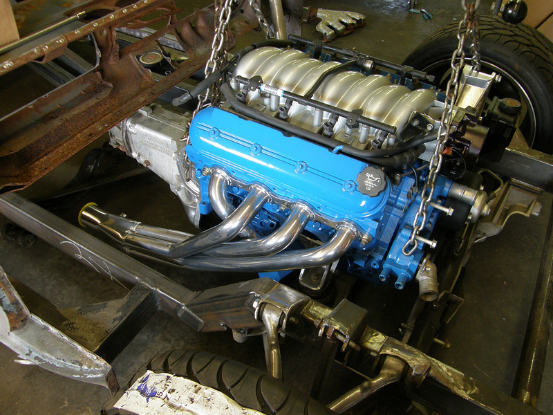

      LS1 and Muncie with hydraulic clutch all together,should set them in the car tomorrow.Ron

      Got the motor and trans set down in place,I'm tempted to put a driveshaft in it, pull the body back off and drive it around like a go cart.My Camaro is about 8 hours away from paint,I block sand a panel a night,man is it boring.As soon as I spray it I'll make some posts on it,but it just looks like a primered Camaro right now.Ron http://mysite.verizon.net/ls6ron/

      that looks slick. wheres the coil packs, and what intake is that?

      Its a painted LS6 intake,the coil packs will be mounted on the rollcage.

      Kind of fell off the wagon and bought my first luxury item,at over{$400}.Tried to talk myself into the manifolds,but just couldn't.GTO headers fit my chassis perfect.Kind of tough on the budget but should help the performance.Ron

      you couldnt ask for a better fit than that.
      and sometimes you just have to splurge, sepecially when youre doing the whole thing on the super cheap. some stuff just isnt availible used.
      but 400 aint bad for a splurge.

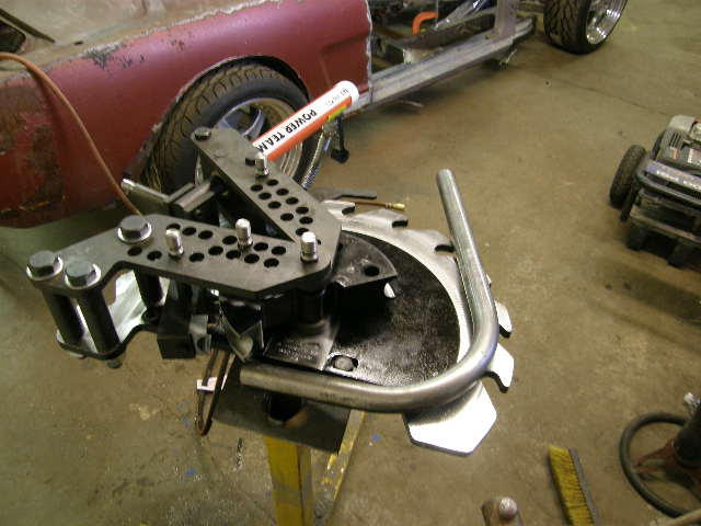

      Just got back from Atlanta,while I was cruising thru Tenn. I stopped and picked up a new toy.Can't wait to start bending some tubing.Ron
      What bender is that? Let us know how you like it.
      Looks like a JD Squared inc.
      model #4 with hyd.
      I have the model #4 an like it well so far.
      www.jd2.com
