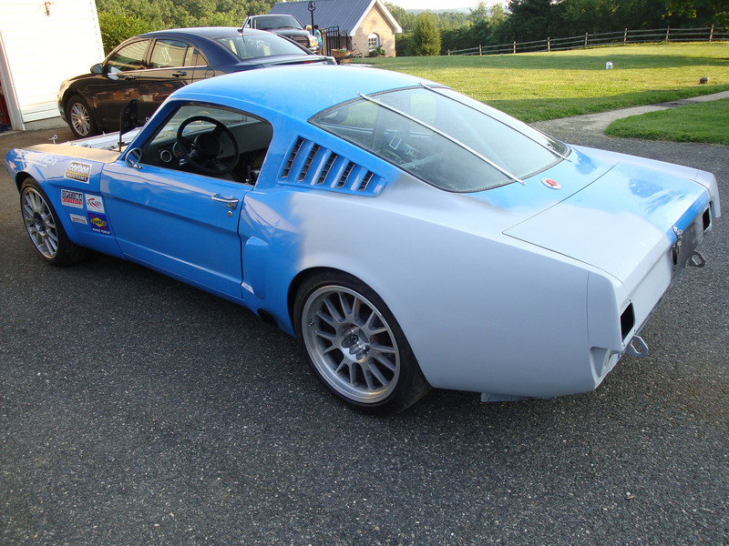

      This car looks incredible do you have flares?
      Maryland
      1,863
      Quote Originally Posted by Dolmaner View Post
      ???? The fenders and quarters are reshaped to cover the tires, so yeah I guess I have flares.
      Ron Schwarz
      May 2002
      Northern California
      10,716
      almost looks backwards with the tire aspect as pictured.

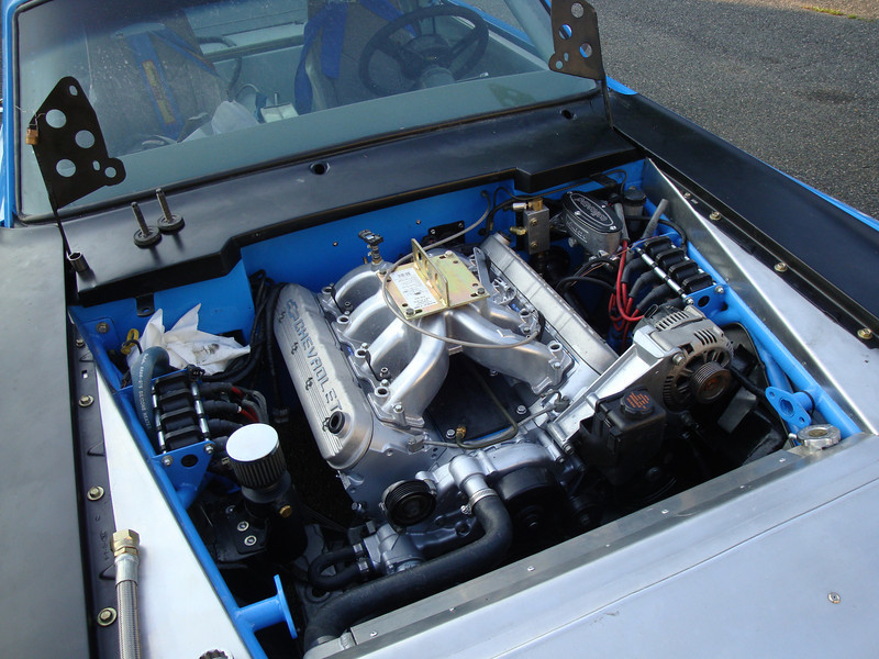

      Not sure where you posted but what headers did you run with the LS1?
      89 Mustang "Box Wine"
      Maryland
      1,863
      Been out of town for the past week, the headers are cheap, Pacesetter GTO headers.

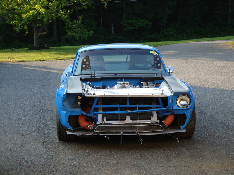

      Pecking at a bunch of little things on this car, got the new shocks and swaybar on. Had an overheating issue last year when I was really leaning on it, got to 300 degrees a couple time at VIR. Don't really know why, at 150 mph I'd think the air would just push through and cool OK. Thought maybe the air was bypassing around radiator because the front of the car was wide open. Started filling in these areas with aluminum, what a PITA. Hoping it funnels the air were it belongs.
      Ron Schwarz
      May 2008
      Austin, Tx.
      1,539
      That should direct the air to the radiator a whole lot better!
      Ray
      May 2011
      Scottsdale, AZ
      67
      I sure like your sheet metal work, great job on radiator director
